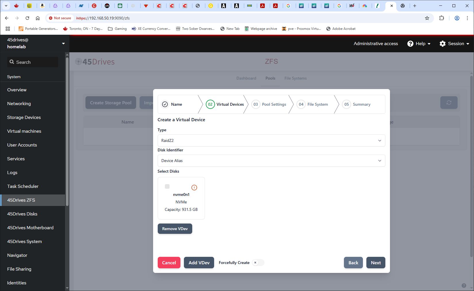

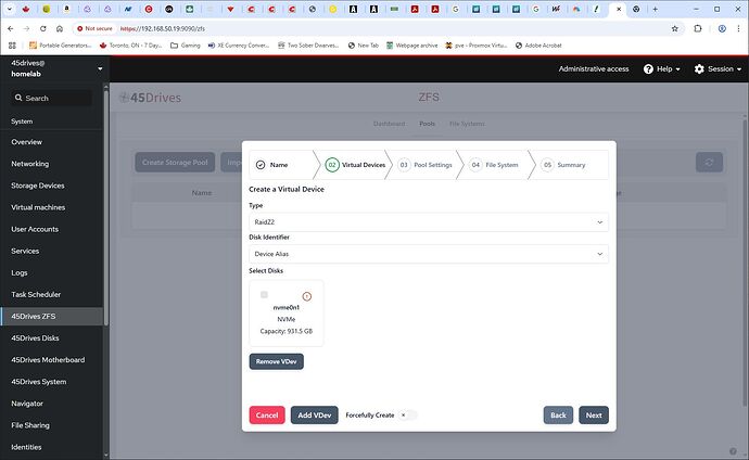

I went to “45Drives ZFS”, clicked the Create Storage Pool, and started the wizard. On step 02, my 8 disks are not being displayed. I cannot select my hard drives to setup the RaidZ2 pool.

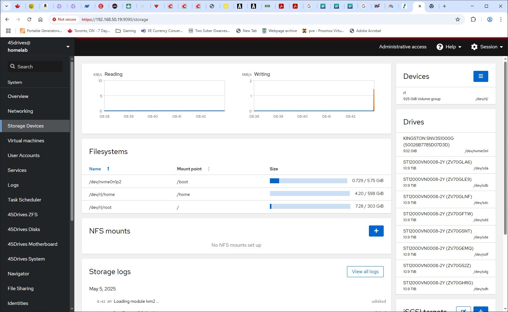

From the menu “Storage Devices” Houston is displaying my 8 hard drives per the OS labels.
Under Storage Devices, each individual disk is flagged “10.9 TiB Unrecognized data” since they’re new and have no partition or formatting.

It’s possible to get some screenshots of what you’re seeing? I don’t doubt what you’re reporting but it’s often good to see the screen in its entirety. Sometimes there’s a detail on screen that doesn’t seem relevant but actually is.

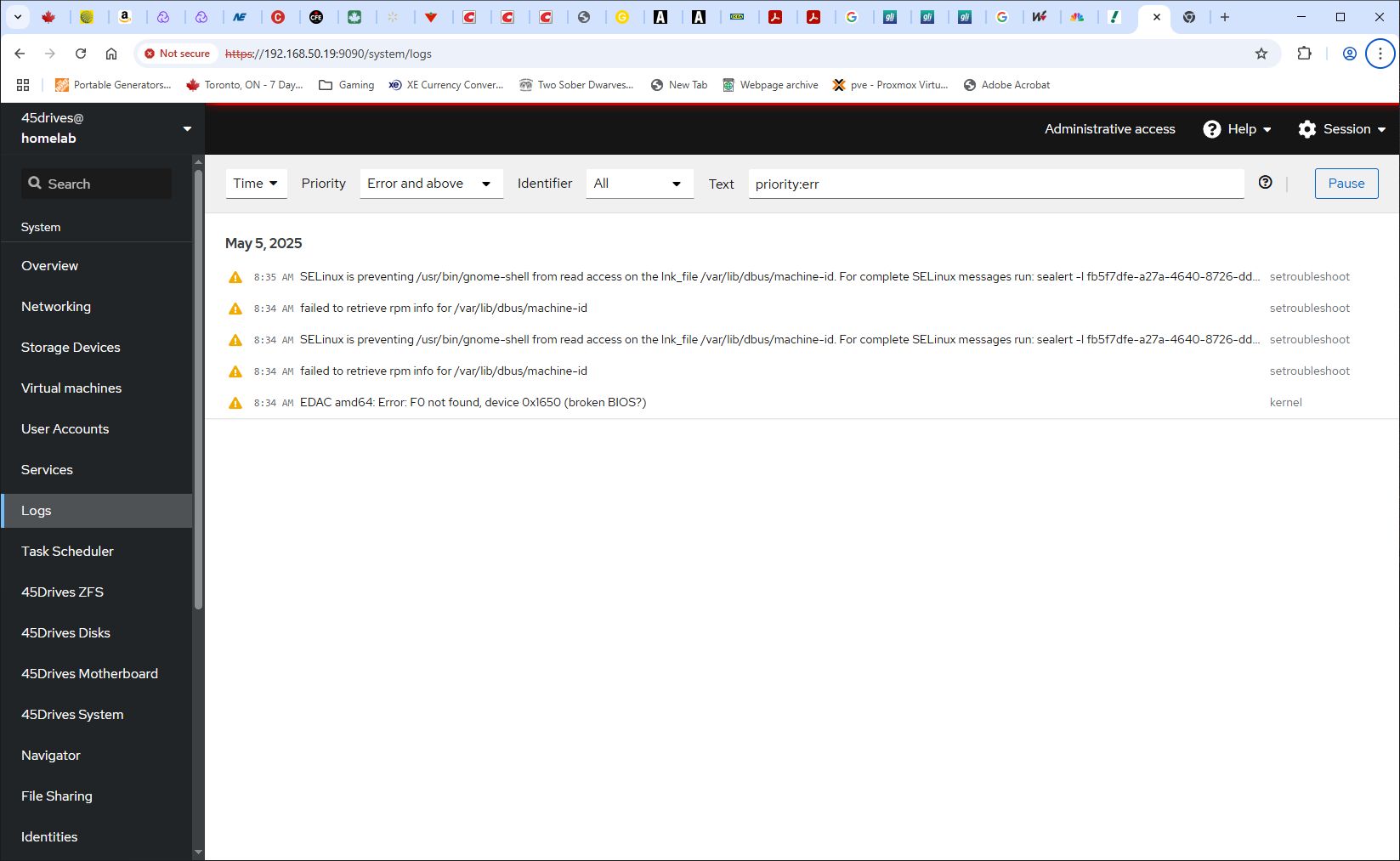

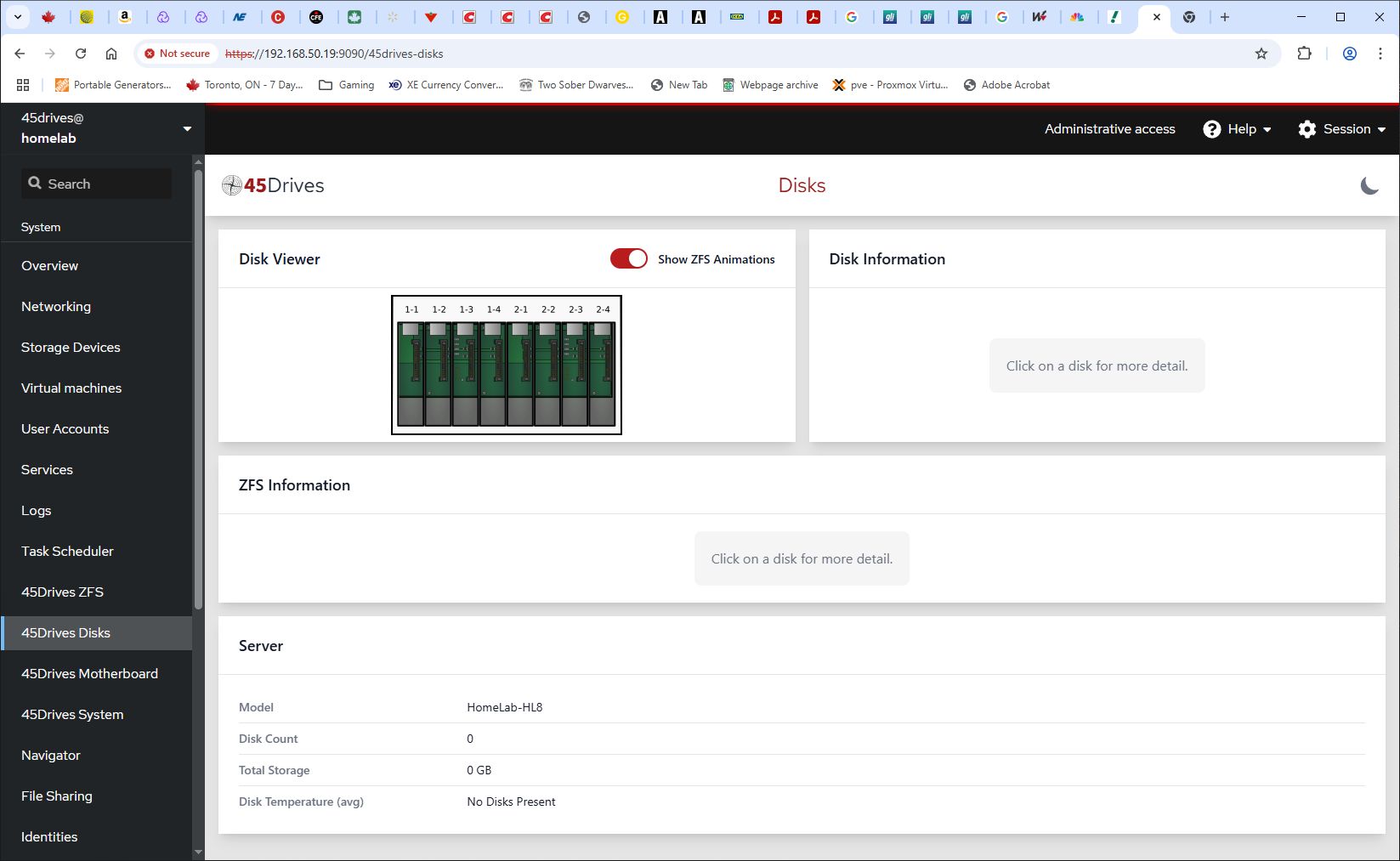

Screenshots 1/4
screenshots 2/4
Screenshot 3/4
Screenshots 4/4
I just powered on the HL8 before I took the screenshots.

Thanks for this @vertaxis! In the wizard, does anything change if switch the Disk Identifier? I think there should be an option to use device path. Aliasing is the way to go but if they show up with a different method that tells us the alias mapping is messed up somehow.
All 3 disk identifiers produce the same result. None of the 8 hard drives are listed.

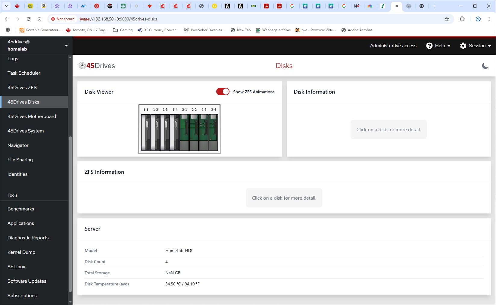

There is a change. I think it sees 1-1, 1-2, 1-3, & 1-4.
It’s not seeing 2-1, 2-2, 2-3, & 2-4.

After a reboot, the Wizard is showing the 4 drives that were found.
