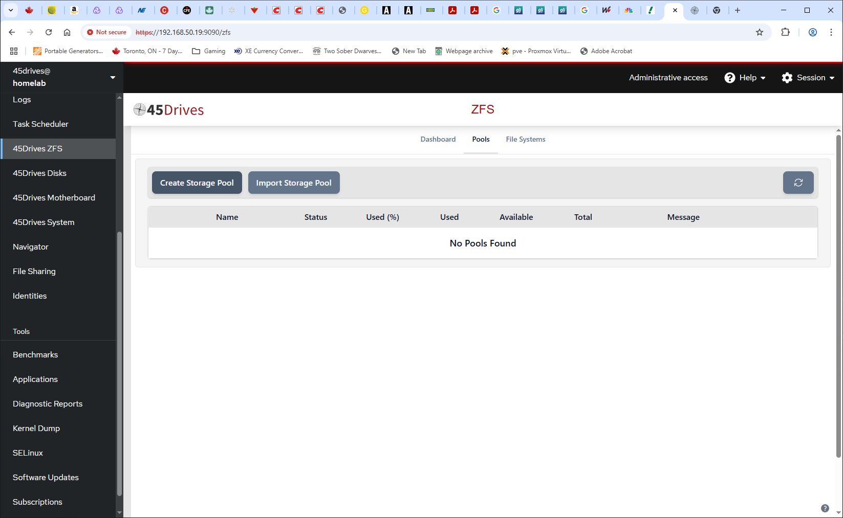

I just tried to create a Pool. The wizard didn’t start the first time, but it started the second time. After going through the wizard, it indicated “Successful” but I am not seeing any pools displayed. After I refresh the page, I am getting No Pools Found.

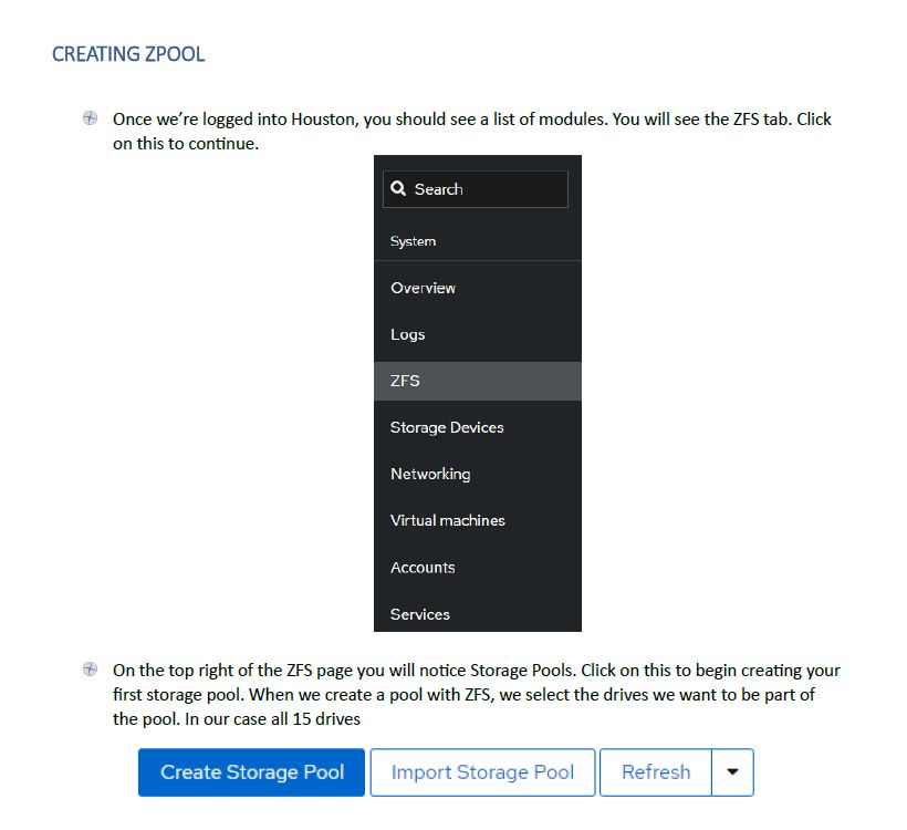

BTW. Th wizard and the User Guide screenshots don’t exactly match. Maybe it’s time to update the User Guide?

Does the old user guide show a different ZFS tab per chance?

From the GUI, No Pools Found.

The User Guide I downloaded fresh from the 45Homelab website has a different ZFS link. It’s “ZFS” and not “45Drives ZFS”
Hey @vertaxis
The pool does look to be intact at least. That is our old ZFS module. I made a few guides on creating storage pools in the new module so I will tell vikram to update those!

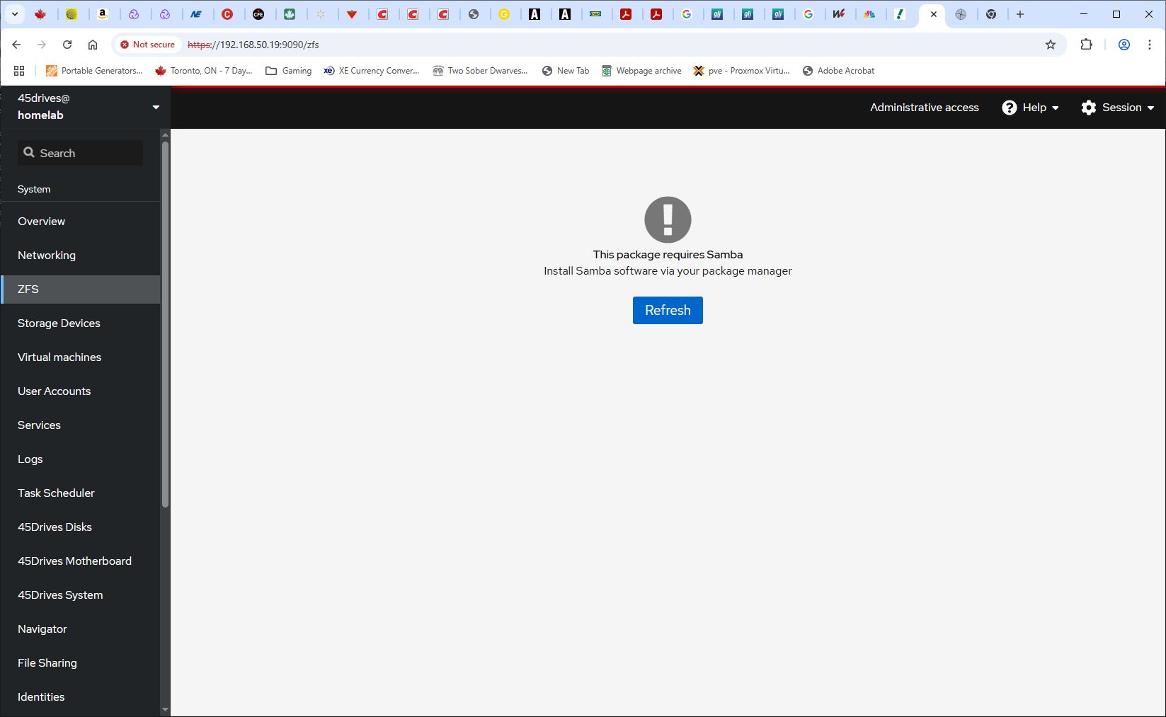

I am seeing the older “ZFS” item in the menu. I went through the config window, and now it’s telling me that I need to install Samba. It’s not letting me view anything else in ZFS. What is the command for installing Samba? Is this something I perform in the GUI, or is there a command line I need to run?
Hey @vertaxis
You can run a
dnf install samba
In the terminal. Reboots when downloading packages are not necessary unless they are kernel headers! If you’re more comfortable rebooting though that works too!

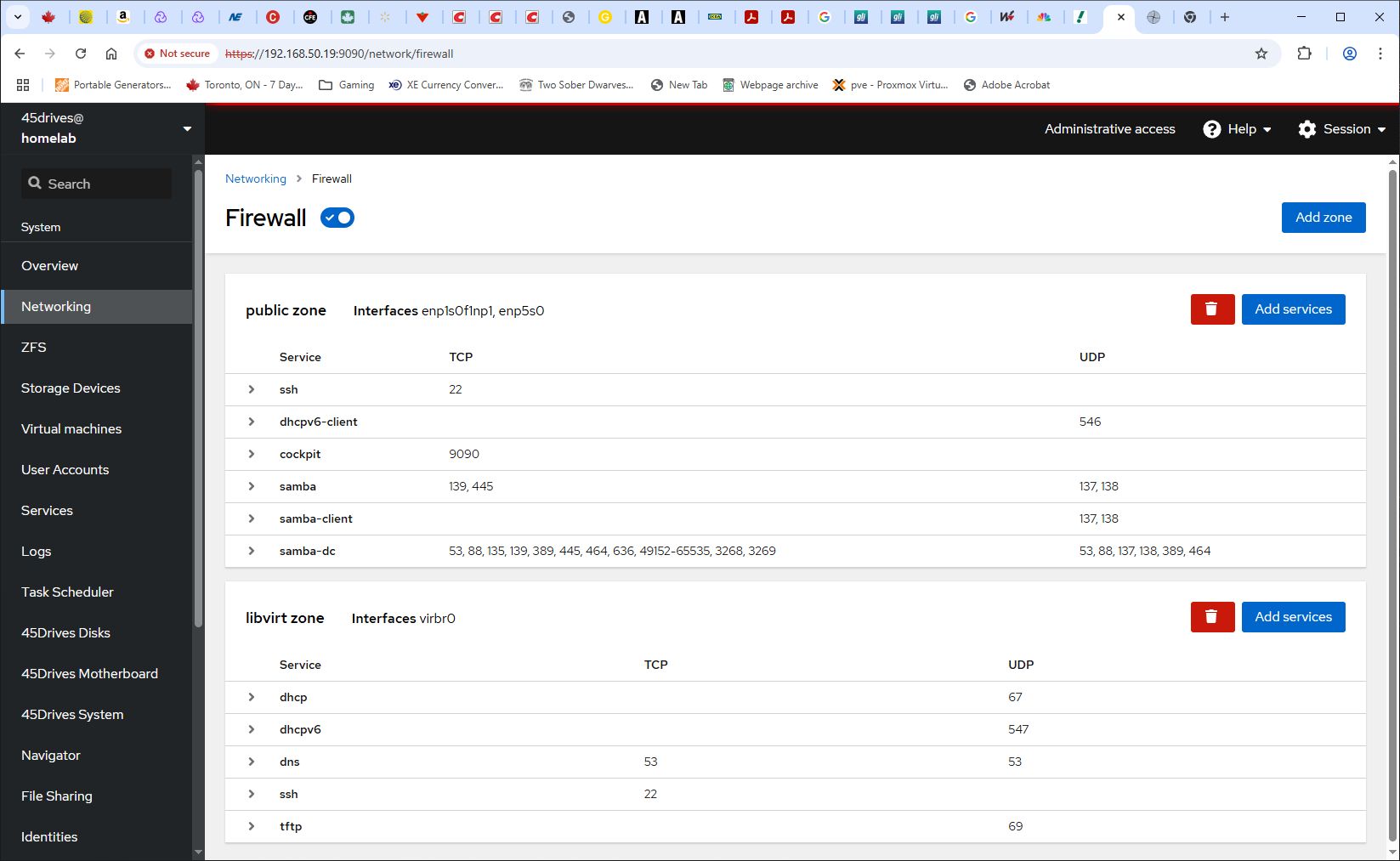

Did you enable the firewall port in the networking tab?
If not you can go to networking → services and add port and search samba/smb
I don’t have access to the UI right now but those should be the steps!
Also the reason you cannot see samba in the systemctl is because once it’s downloaded it changes names to either smb or smbd which can be enabled either through the CLI or through the Services tab!
Yes. I did enable samba on the firewall.
Networking >Firewall >Edit rules and zones
samba, samba-client, and samba-dc are in the public zone.
The smbd and nmbd are not running. How does samba get started on this system?
