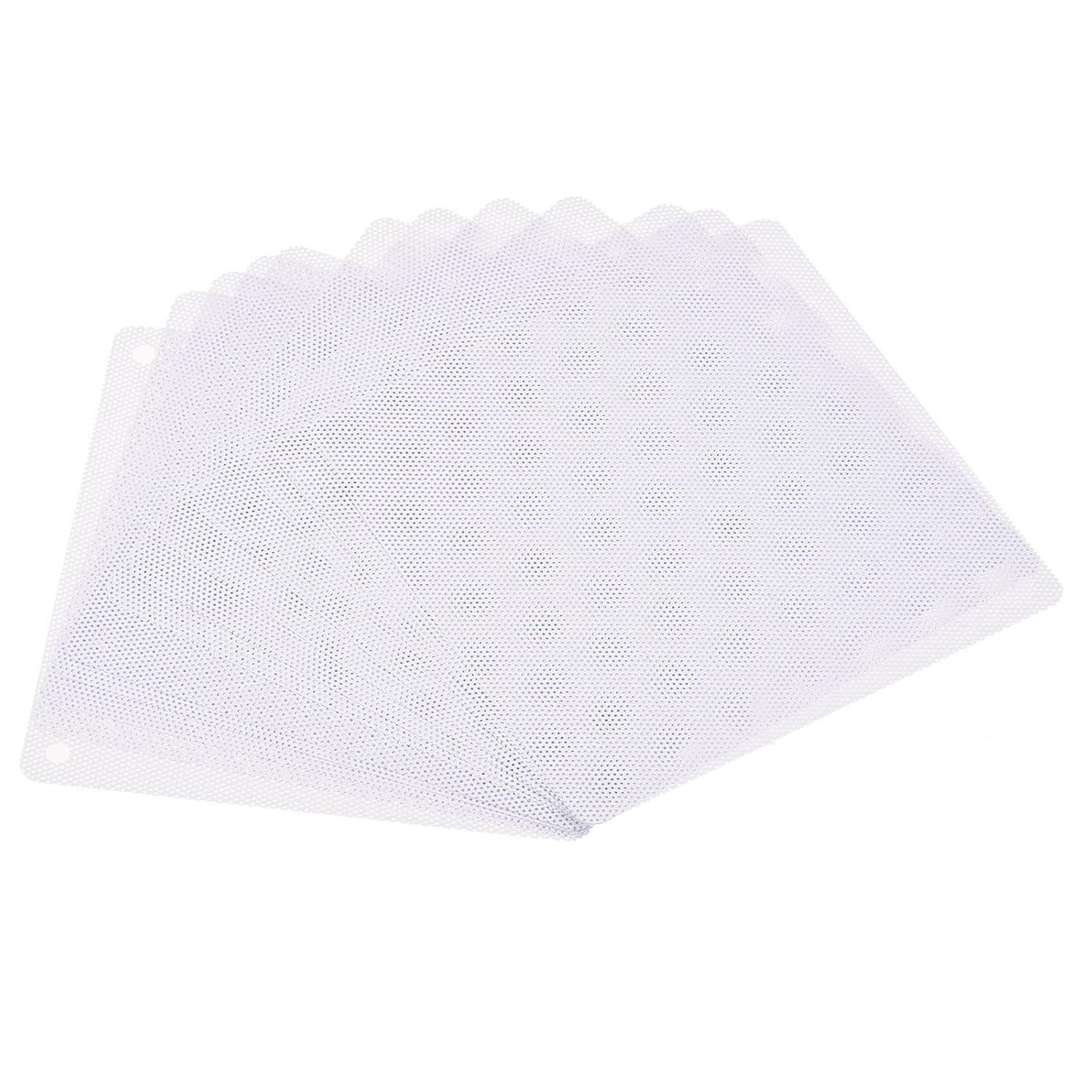

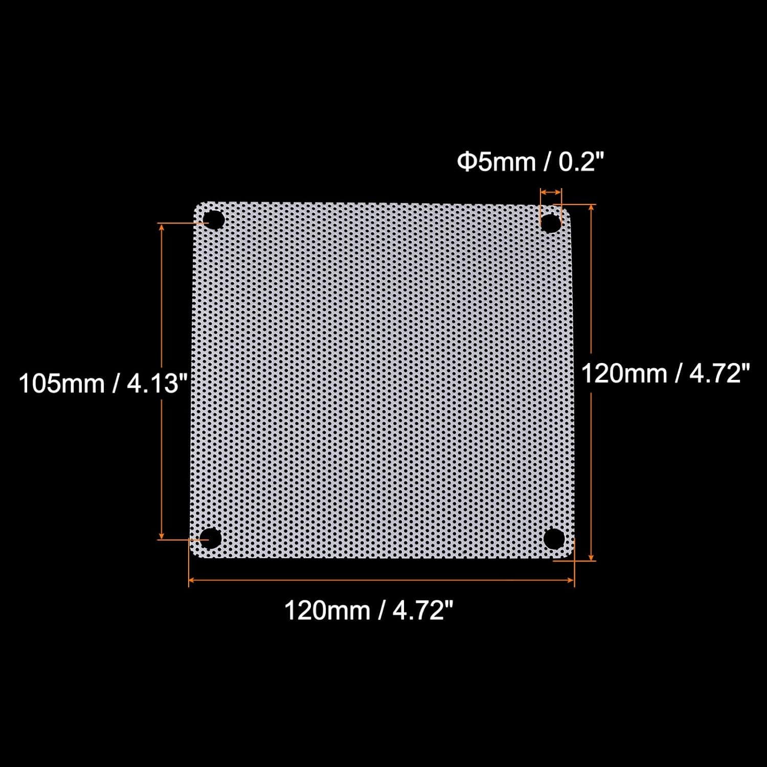

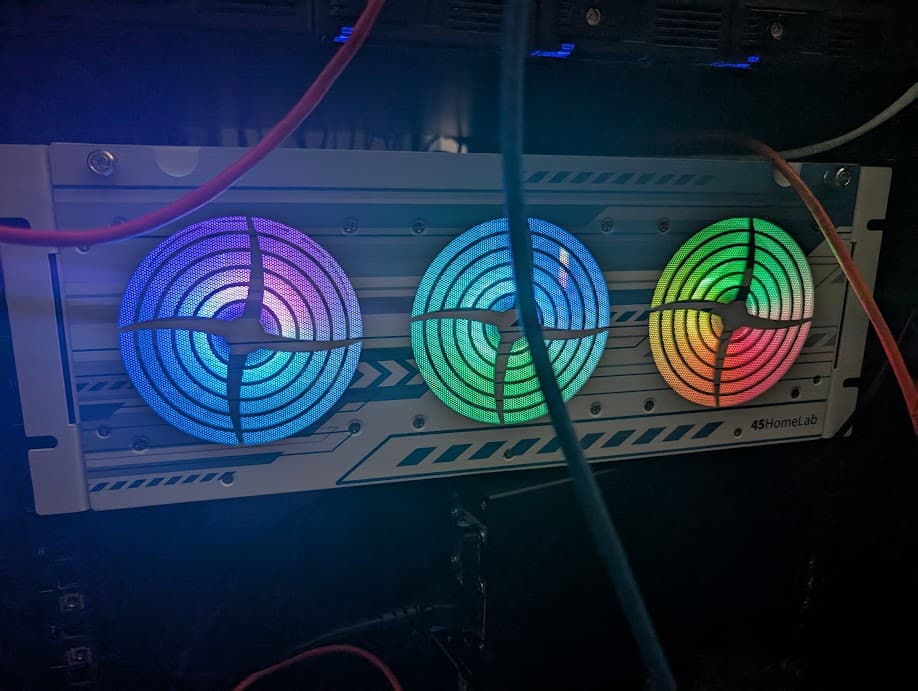

I dont know if put the fan filter behind the fan is a good idea. I just use this filter between fan and the front face.
And it looks like this (ignore those cables)
It looks to me like it’s going between the fans and the front face. Your solution leaves a clean look, but requires disassembly to clean the filters..

What filter did you use? i got one the the holes were so small that air wasn’t going thru haha
