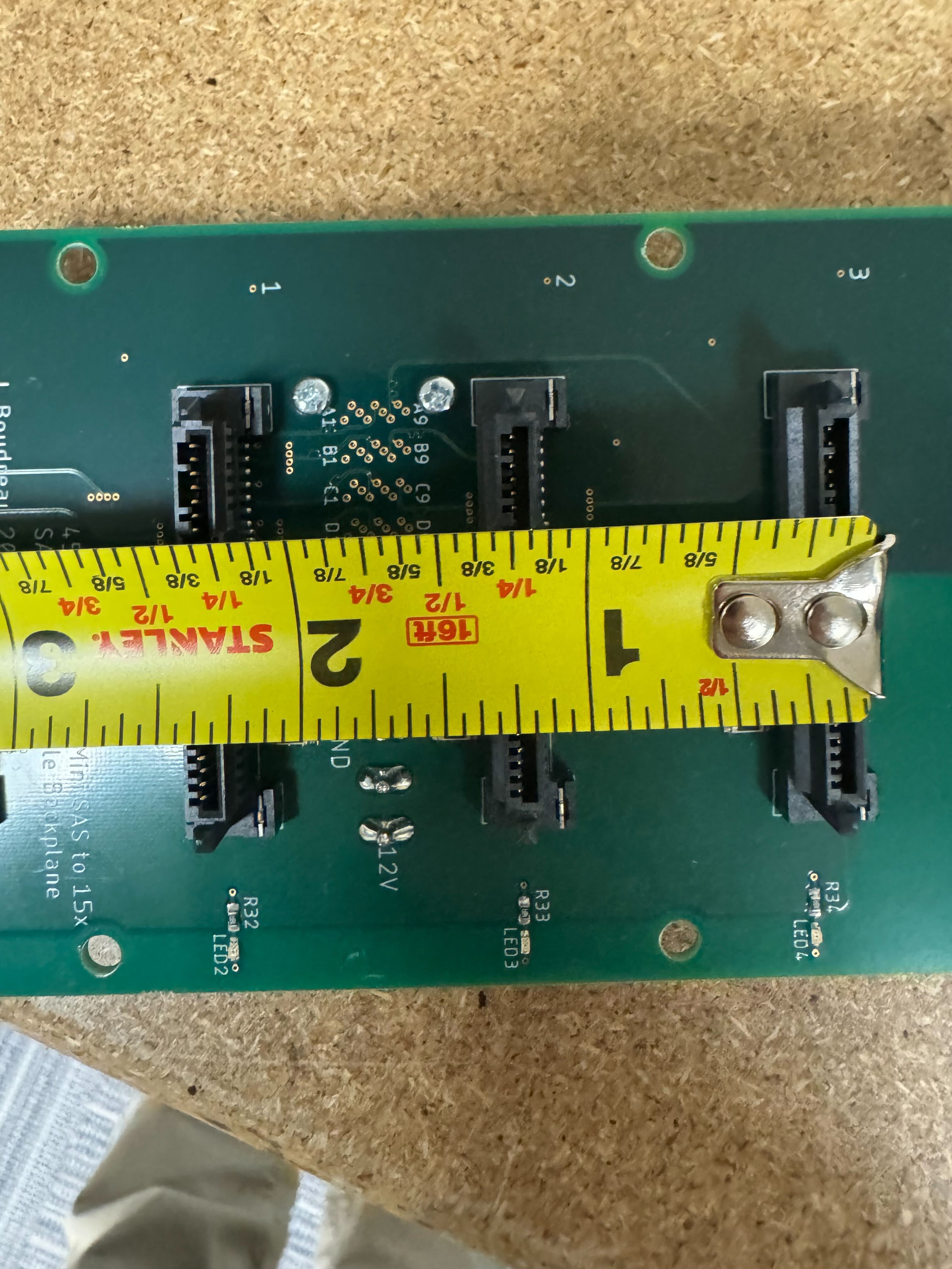

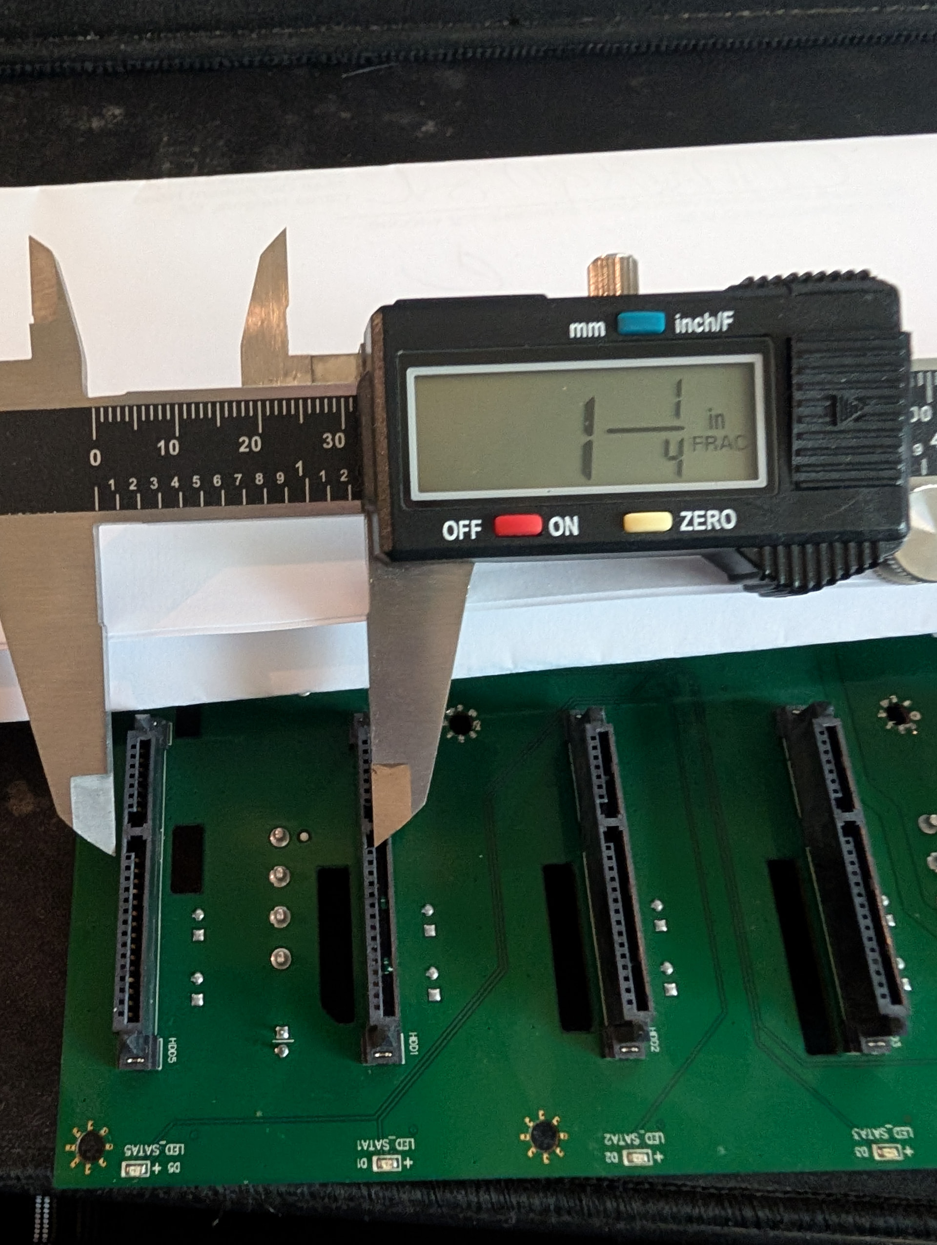

@blitz From what i’m seeing the drive spacing is the same, the pcb is much narrower and mounting holes are different spacing. Looks like the spacing is 1.25” (from top of connector to middle of next connector) between sata connections according to the picture that i got from 45 drives…i confirmed it with one of my boards (Picture with calipers, tape measure on the next post is 45drives)
Seems like it might be a little tricky to get the standoffs to work, but could be doable.

Even if the connectors are spaced the same (which I’m not convinced they are from your photos), you still may not be able to get them lined up correctly with the metal cage. I mean, the differences may be in mm, but the fitment has to be pretty exact for the drive to slide into the connectors.
I’ll add, while the drive spacing may not be the same you could design a new drive cage for the revised spacing. Since you seem to already have a backplane that may be the most cost effective way forward. It shouldn’t be too difficult, just shop around at a couple places to get the best price, local shops, Send Cut Send, Oshcut or Xometry for example.
