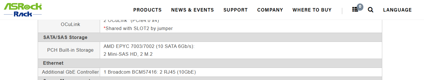

And the ROMED8-2T/BCM motherboard only supports SATA, correct? That’s how I’m reading the spec sheet on ASRock’s website.

Hi @rymandle05 You’re correct that the ROMED8-2T/BCM supports SATA, but it’s not limited to that. According to ASRock’s specs, the board provides ten SATA 6 Gb/s ports via mini-SAS HD connectors, and it also includes two M.2 slots that can operate in either SATA or PCIe 4.0 ×4 (NVMe) mode.
So, in short — it supports both SATA and NVMe storage, depending on which slots you’re using
Thanks @rachit-45Drives - summarizing, the default configuration with the ASROCK full build is 15 HDD SAS/SATA via HBA and 8 SDD SATA only via motherboard mini-sas-hd connection. NVME can also be available but not through the backplane.
