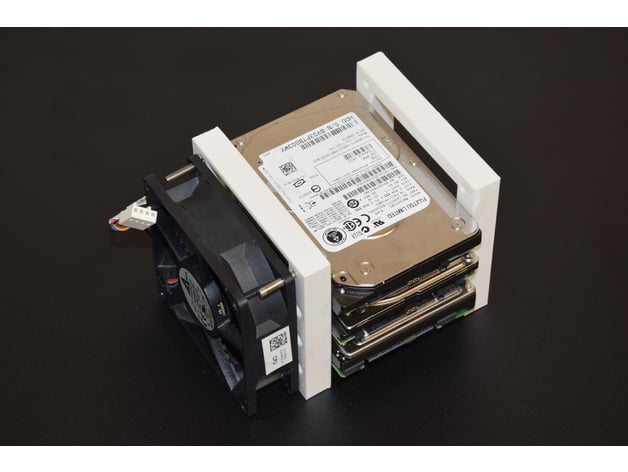

Is there any plans to have a cage replacement for the SSD backplane so we could use some 15mm SSDs in that area? Before I purchase, I wanted to ask because it influences which machine if any will work. Use case here is some 3.5” spinners in the front, but then I have an array of 15mm SSDs (as I imagine many people have,) which I have to find spots for. I can put them in the 3.5” lanes, but I am out of room with the size of my spinner array, so need some extra spots in the case to use. The cage for the SSD area looks like it could easily be made to have 2x15mm SSDs on the two ends, with 7.5mm in the middle. Is this an add-on that could be considered? Alternatively, is there any add-on bracket for the 2.0 so we can add a few 15mm SSDs outside the main front backplane? Theres some community 3d prints, but is strange that the option isn’t available in the store.
HI @derringer
I appreciate your feedback. And no, we do not have any plans for this as of yet, but I will share this feedback with our R&D team to look into this.

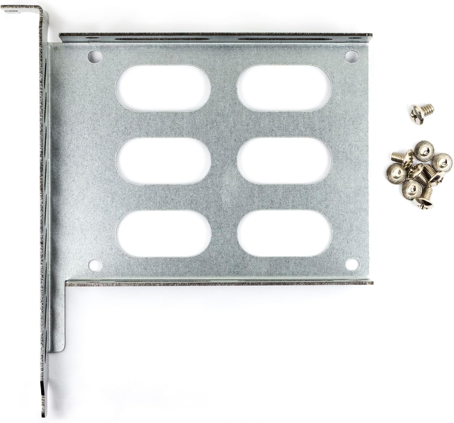

Not sure what else is going on in your build. The downside of the “official” 3D printed brackets and remixes is they go over the IO shield area, blocking airflow and potentially being physically in conflict with an active CPU cooler taking up some of the same space. I assume you saw this thread; 15mm SSD Mounting Bracket?.
Not sure how big your “array” of SSDs is, but one option for the HL15 would be to mount them in the PCIE slot space;
If you went with the Beast, you could look at non-45HL-specific SSD brackets like this;
or the docks with backplanes from IcyDock and StarTech, some of which accommodate 15mm SSDs.
