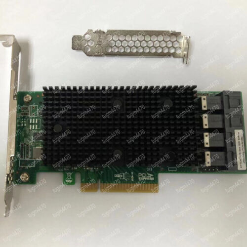

I picked up a LSI 9400 from tugm4470

Would this work? LSI 9300-16i 16-Port 12Gb/s SAS/SATA HBA ZFS TrueNAS UnRAID IT Mode 16.00.12.00 | eBay
I’m getting SFF 8644->SFF 8643. Not sure how to tell which HBAs support that.
In this case you would need the 4x (SFF-8643 → SFF-8643).
The listing linked does not mention what ports the card has but googling the pdf technical specs mentions “Connectors SFF8643 (x4)”.
my hero! Thanks so much @ZVeguillaCotto
