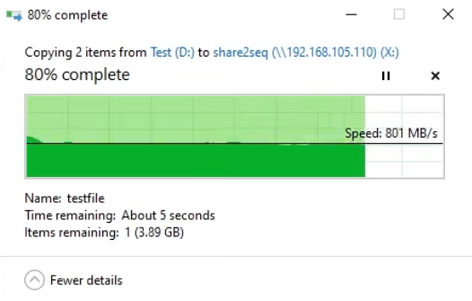

On a 10GbE network switch (which could further bond the 2 interfaces for even faster theoretical read/write speeds)

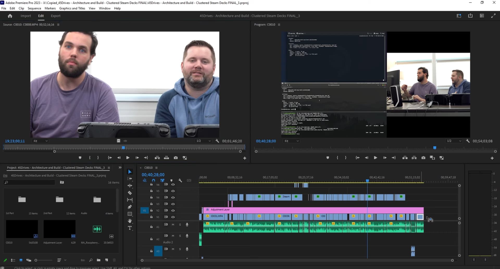

New video-editing workflow demonstrated working directly off the network at nvme-level speeds, no need to download your content locally ![]()
All these tests were showcasing ZFS on Rocky Linux

HI All,
Here are the specs used for that video
Hardware Specs:
Motherboard: X11-SPH-NCTF (Supports IPMI)
Processor: Xeon Bronze 3204 (6 Core & 6 Thread)
Memory: 2x8GB DDR4 RDIMM
Boot Drive: 1TB Kingston M.2 NVMe
Power Supply: Corsair RM750e (750W Modular ATX)
Configuration:
14X Mirrored VDEV Zpool
64K Record Size
noatime,compression=lz4,sync=disabled,arc=70% (added 20% over default)
10G network RX/TX buffers increased to 4096
CPU on server set to disable C states/P states: tuned-adm profile network-throughput
cpupower governor set to performance (command: cpupower frequency-set –governor performance)
NOTE The above Configuration changes were made purely for performance and are not intended for a day-to-day workload. We would advise against these settings if you are storing important data on your server
