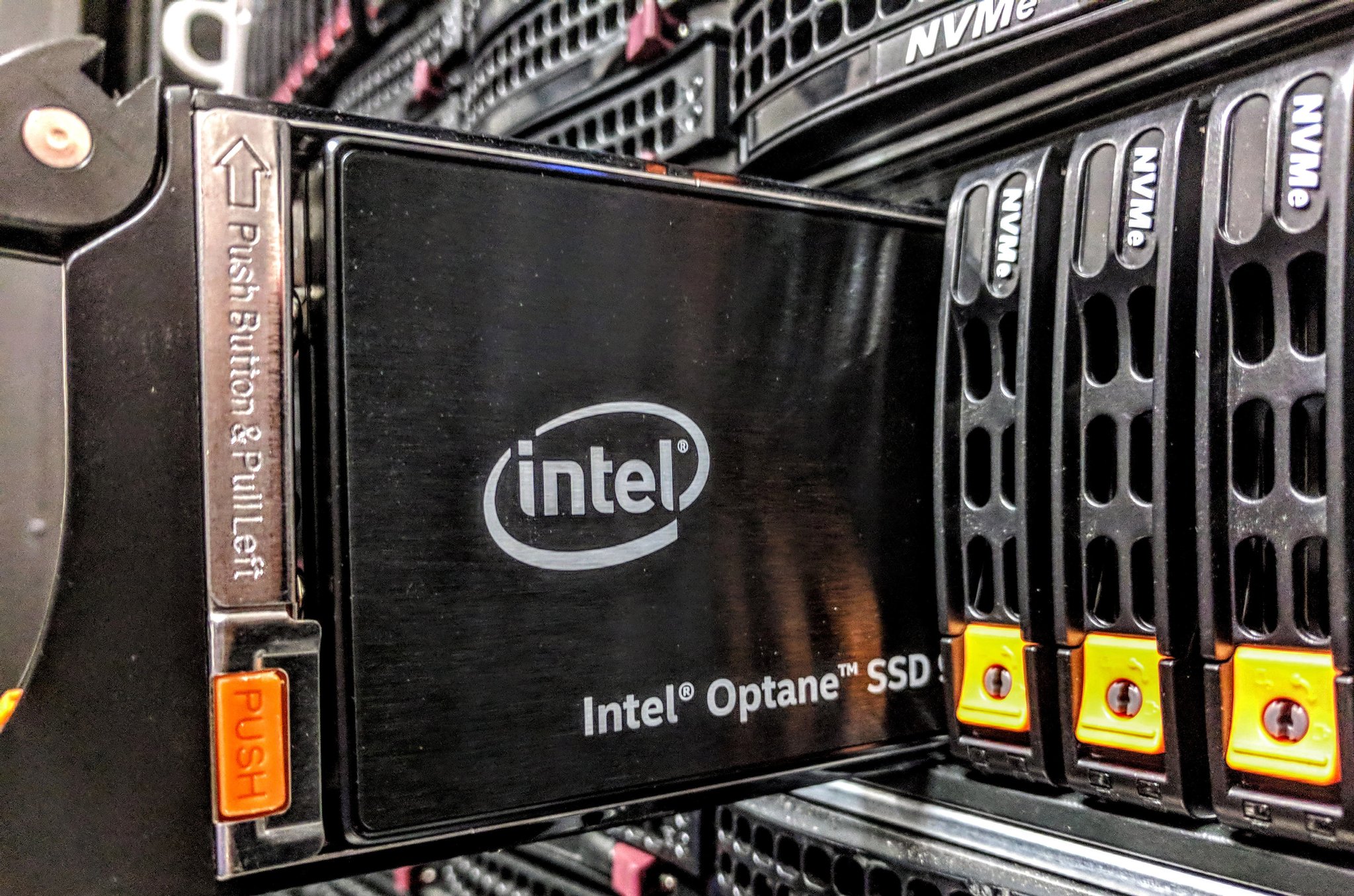

fio or iozone, it takes some time and effort but if you really want to dig into how your system differs with/without it’s worth the effort. Also p1600x optane drives are pretty cheap for what they are and they make perfect SLOG drives. You can also look at other optane drives for l2arc/special devices since most consumer nvme aren’t all that fast once you hammer them with high IO operations. There are other high IO options out there depending on your budget and willingness to track them down (generally second hand enterprise drives).
…wtf? something’s bugged.
ty for the heads up about using the optane drives, was just starting to think through those options
No idea at the 5 month thing. Took a look this week and it looks like prices on p1600x’s have actually gone up a bit but you can still find the 58gb versions for under $40 on ebay from newegg. 2 of those would make perfect slog drives unless you happen to be running a 100gb network.
