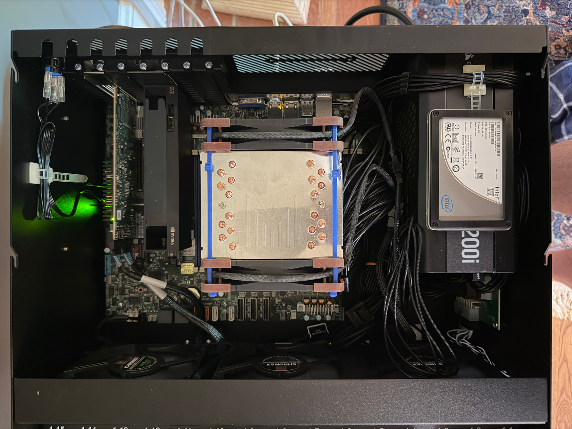

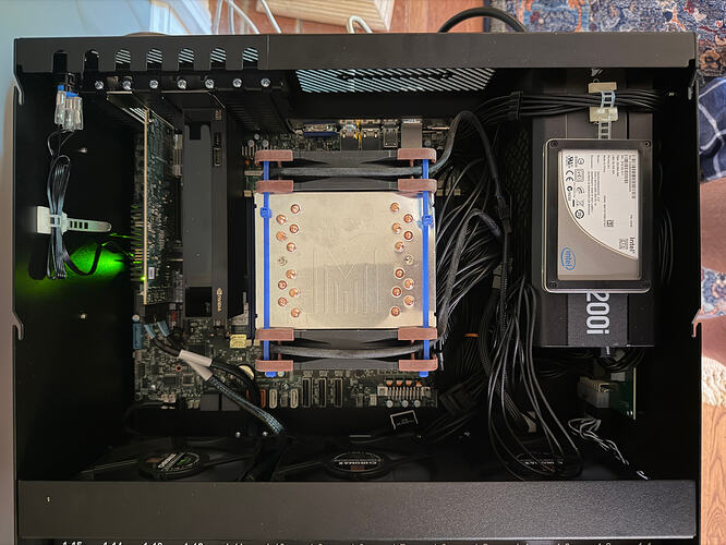

For those interested - the Arctic Feezer 4U-SP5 fits fine. the configuration is a lot different than the noctua cooler you see in a lot of HL15 builds online and really leaves a lot less room in the back of the case and the way folks are mounting SSD’s in the bracket back there wont work. But the clearance is GOOD to the top of the case.
Note the mighty fine zip tie installation method of replacement Noctuas on the arctic
