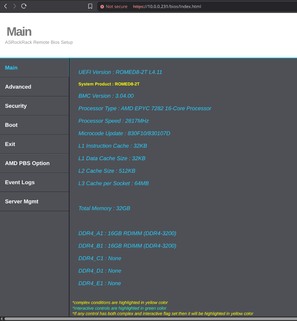

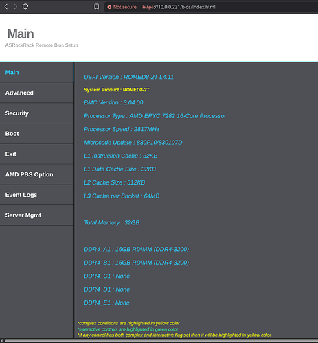

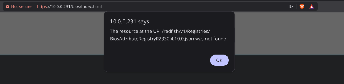

I recently acquired a ROMED8-2T motherboard for my HL15 V1.0 and I noticed I could not access the BIOS from the IPMI interface. I get the error included below. Looks like there’s a problem with BIOS P4.10 and/or BMC 2.08.00. I reached out to ASRock Support and they provided updated, but unpublished, firmware via a google drive link - BIOS L4.11 and BMC 3.04.00. This fixed the issue with the IPMI BIOS link.

We have been able to narrow the cause down and confirm that it is not related to the BIOS version. Instead, the behavior appears to be tied to the BMC version. Our findings are outlined below for clarity:
  • BIOS 4.10 with BMC 2.02 works as expected
  • BIOS 4.10 with BMC 2.08 does not work as expected
At this time, we do not have any motherboards in our inventory running the newer BMC 2.08 version. This is why we had not previously encountered or observed this issue.
