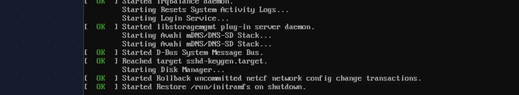

Leaving the Live CD mounted and pulling the external USB disk, the internal Rocky 8 hung in Disk Manager as shown.
I’m thinking that my earlier play has left something not quite right. Not sure what.
