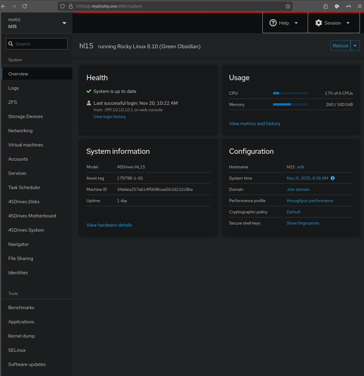

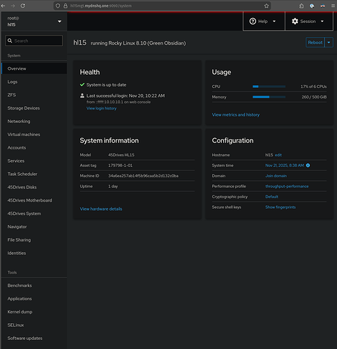

I shared some of the images to show how normal this HL15 box (was kept) – my homelab / home network has a whole FQDN as well
All the 45Drives components were kept – but I did upgrade the memory from the core product sku.
