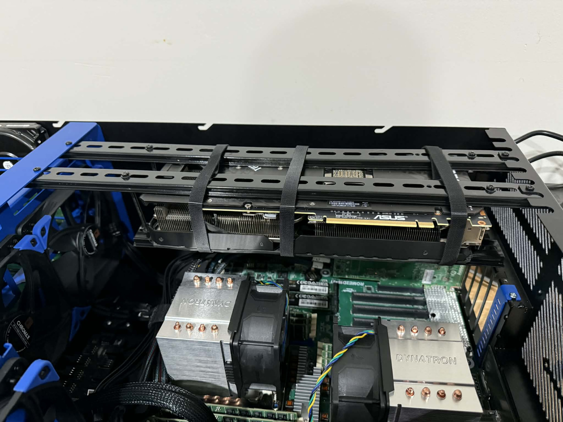

Would be nice to see some kind of way to vertically mount graphics cards. Using my 3090 in the case takes up quite a few PCIe slots that I would like to use for other devices. I have made my own mount that isn’t great, but does the job. I then used a PCIe riser cable to connect the card to the board, saving myself from losing 3 slots to the chunky card.

A few issues I ran into were:
Getting the mount high enough to still allow other reasonably sized cards to be used in the PCIe slots. I have two Silverstone ECM40 cards I am using for NVMe drives that I needed to fit.
Designing a bracket that secures the card firmly without applying pressure to the shroud or fans, as this can restrict fan operation.
Ensuring the bracket provides adequate support to prevent sag, while having minimal impact on the rest of the case layout.
Positioning the bracket so it still accommodates the riser cable, power connectors, and maintains sufficient airflow around the card.

I used Din rail for the bracket, which I drilled a couple of custom holes in for the bolts. Two running across the top and two along the bottom which is used to carry all the weight of the card. There is some longer bolts holding the pieces of rail together on each end and they are not tight, as this would squeeze the card and stop the fans rotating. I have some foam in between the rails and the card, which i couldn’t find a link for sorry but any kind of rubber or foam should work. I then just have some thin Velcro ensuring the card can’t fall out of the rails. Have put links to the rail and the Velcro below.
