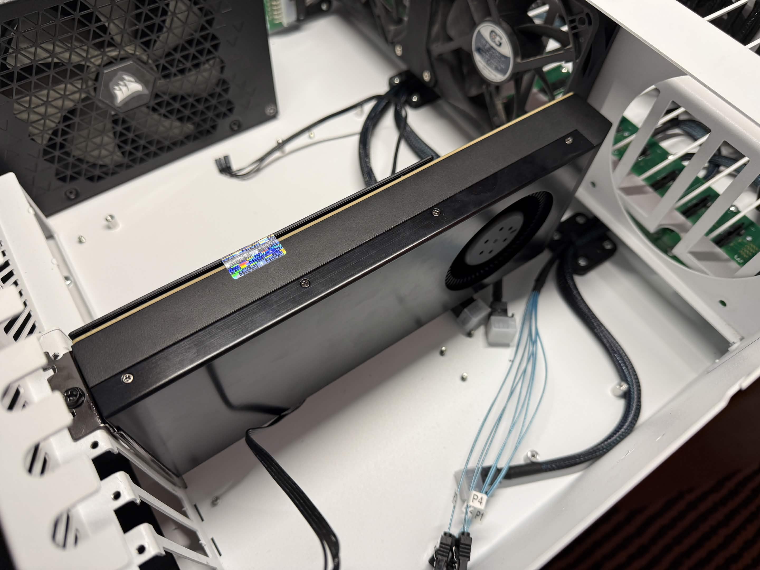

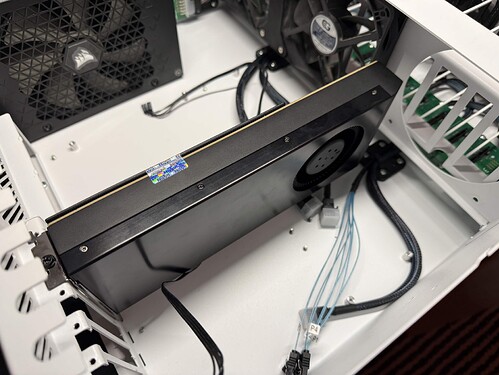

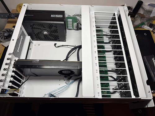

I have elected to go with a modified Nvidia 4090 with 48GB of vRAM. However, I found a shop not too far from me within the US that makes them. It’s called GPvLab and he has a Youtube Channel where he shows his shop and the process of making the cards.
I have just gotten the card in and I cannot wait to get it slotted in my new HL15 build. I will be back to report how this goes.

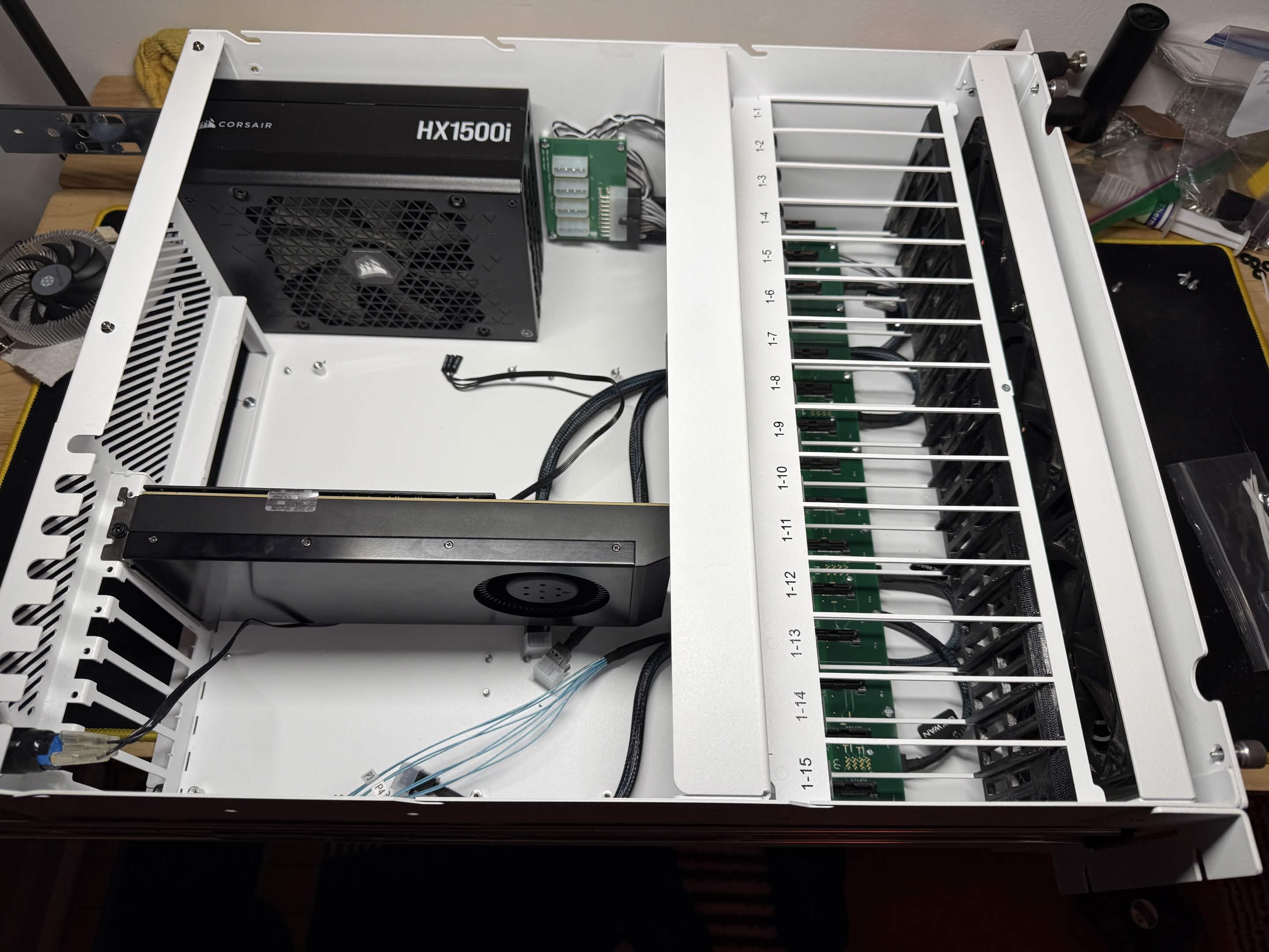

Progress is being made. I will make a dedicated post to the new build when it’s ready, but I got it parted out, cleaned up, backplane cables replaced, and tomorrow should be the big day. A high density VRAM/GPU, high compute, HL15 is on the horizon!

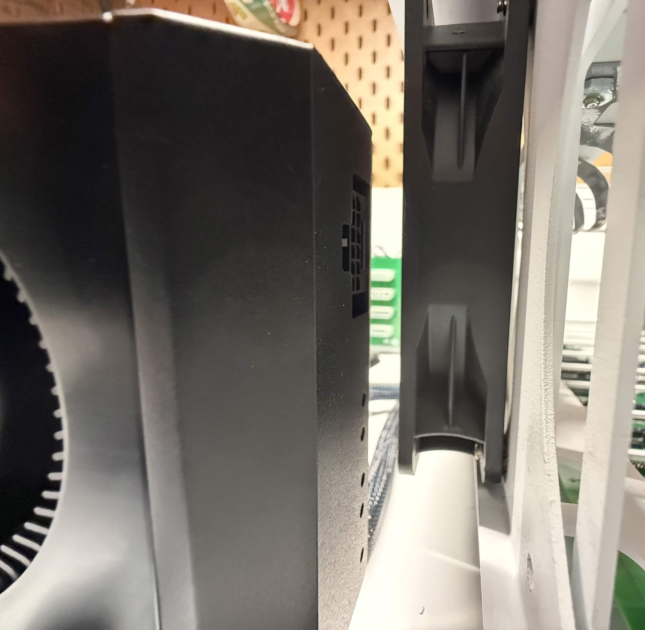

Wow, just barely fits eh! Do you think you’ll put that third fan back in or no?
EDIT: I see the power connector is at the back, so I’ll assume it’s a no :slight_smile:
I will not be re-using the OEM Cooler Guys fan, No. However, Noctua does make a very thin 120mm fan that I’m going to look at. In addition to that, there is a very large gap between the drive cage and the fan bracket. I’m going to be looking in adding an 80mm fan there.
