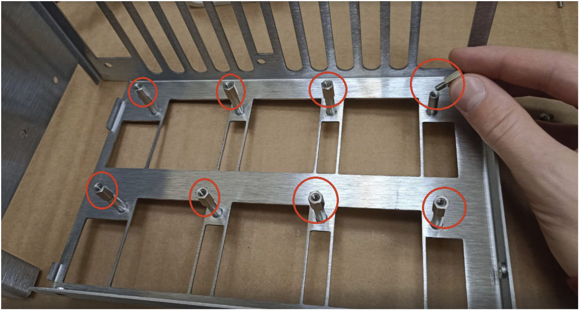

Finally getting back to this. Anyone happen to know the size of the little brass standoffs? Im thinking they must be 6-32 screws as the rest of the system is. Just wondering if there are stand motherboard standoffs or a specific size.
I’m referring to these ones.
