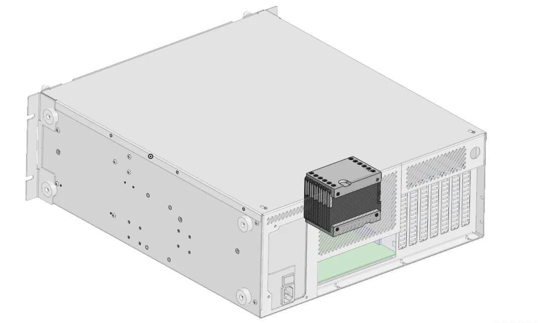

  2. I got the 6Bay SSD Bracket Kit, and just curious if there’s a specific mounting point recommended. The only place I can think is to the case fans that sit between the motherboard and backplane.

  2. This bracket will attached to the back of the case near the PSU and above the motherboard I/O.

I’ve seen a couple of posts on here about people getting 2 of the 6bay units, how are they installing them? Do they just get connected together, or are there 2 mounting locations, or are they doing something custom?
Also, ideally, I’d love to see a ln 8bay version of this!

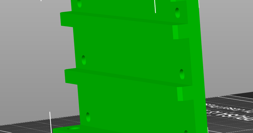

I don’t use these brackets in my setup so hopefully someone else can way in. Just looking at the diagram, it looks feasible that rotating these mounts 90 degrees might allow for two mounts to sit side by side.
Also a few people have done remixes of the STL’s. Providing here in case these fit your needs better.
