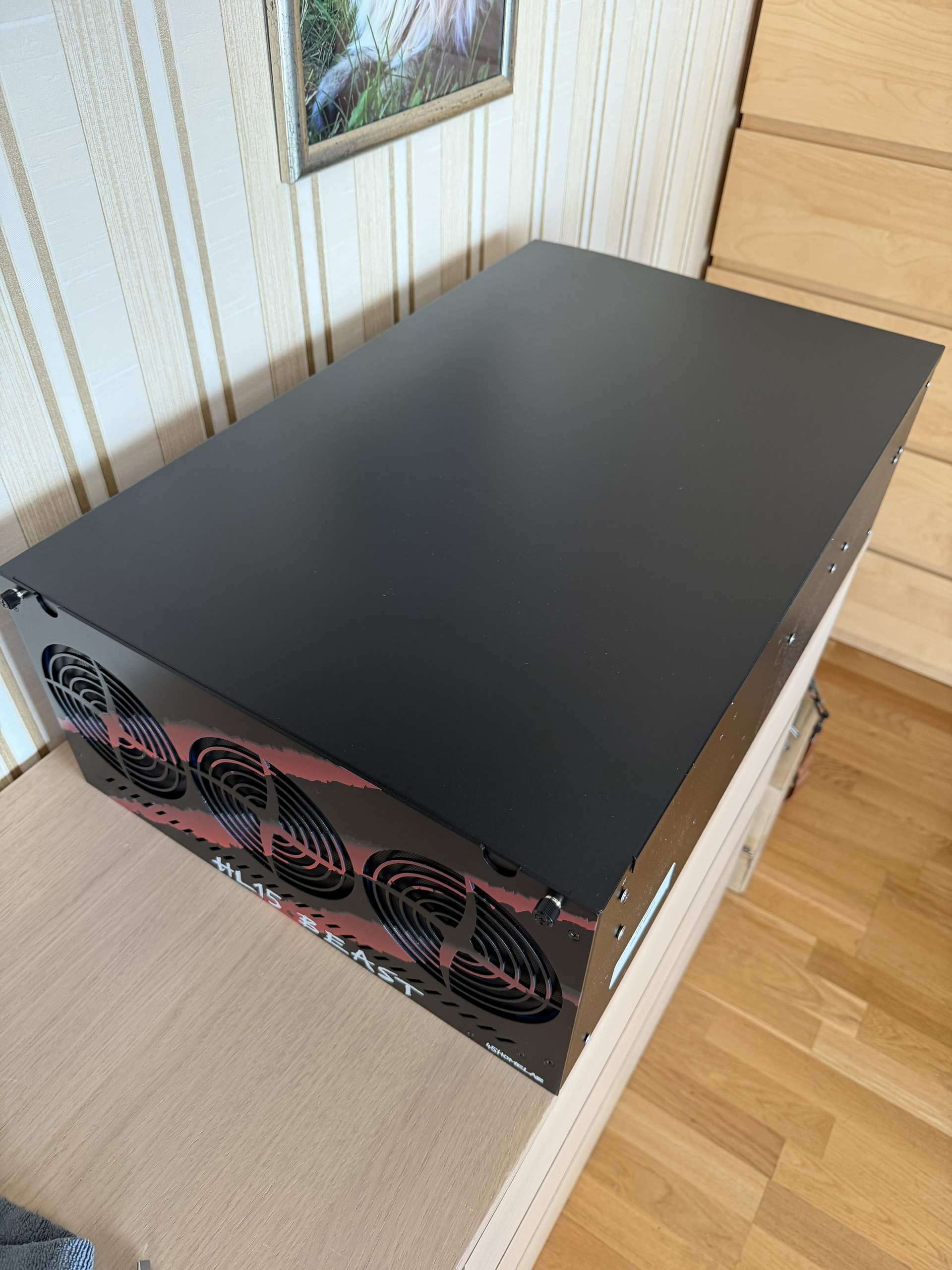

My homelab HL15 beast has arrived!

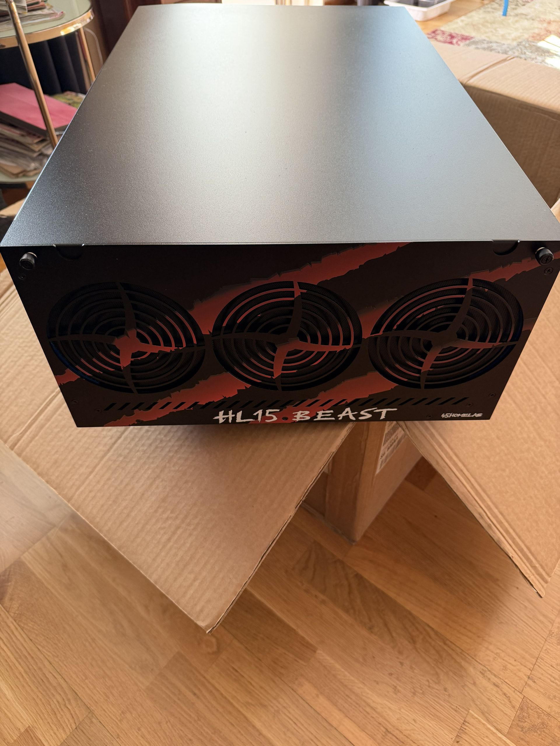

This little peace arrived a few days ago!
A big beast!
The shipping went smooth, all the way to sweden!

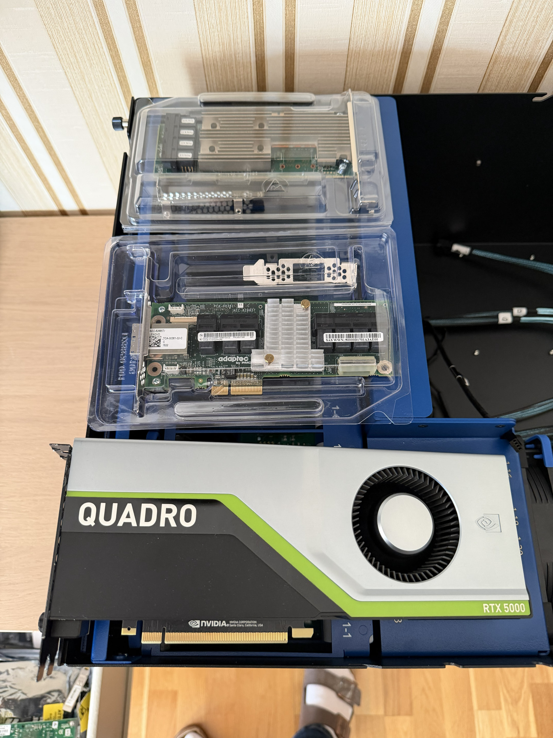

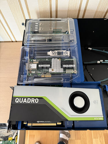

some of this stuff is going in!

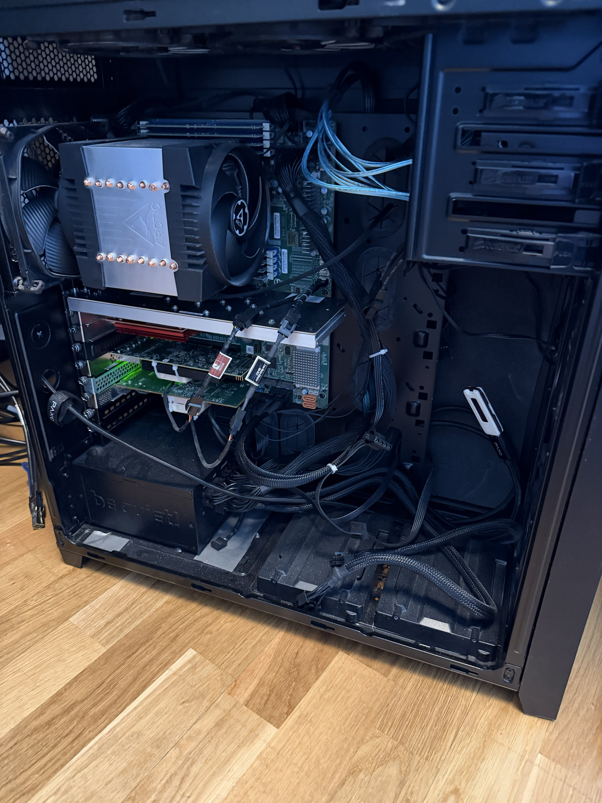

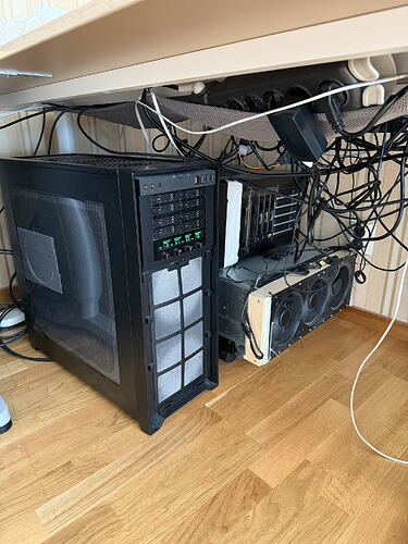

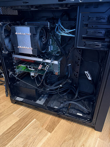

This beast is going to replace this mess!

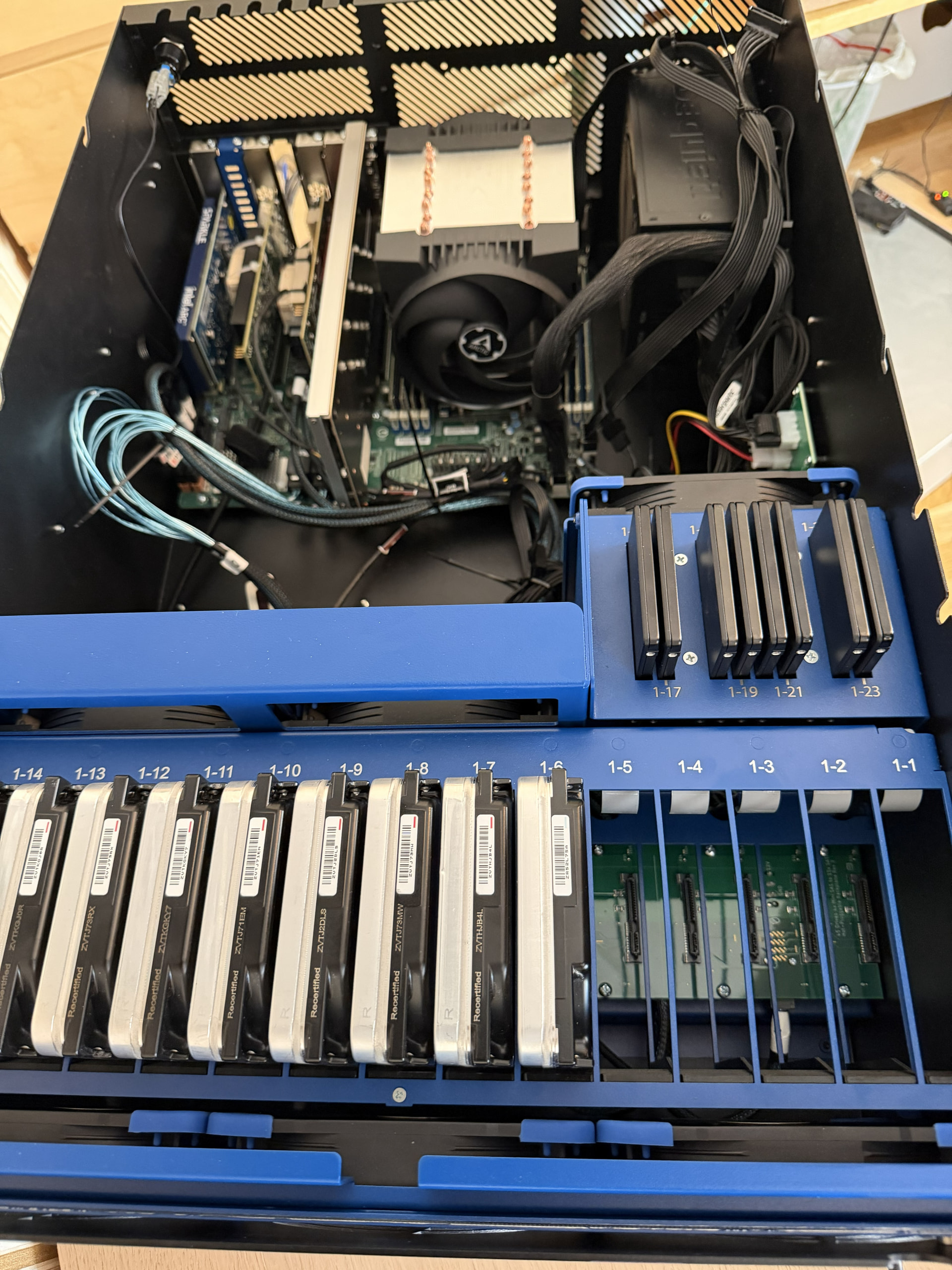

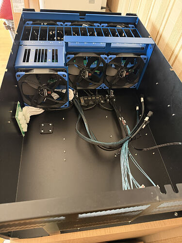

So let i begin!

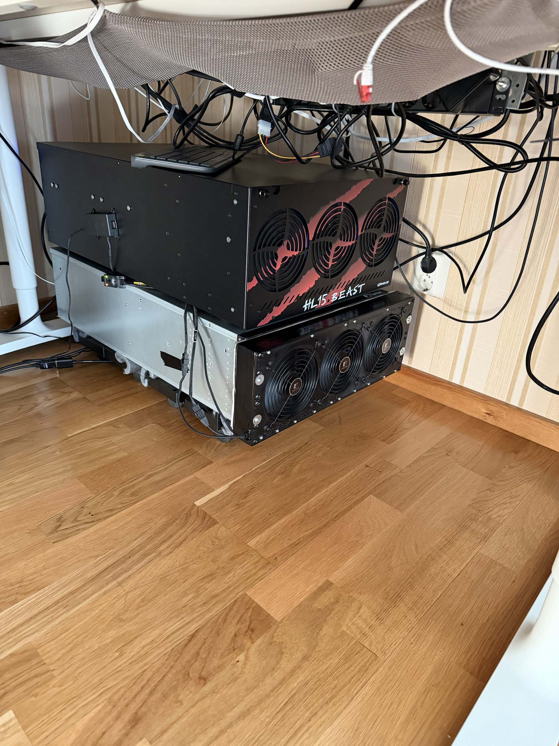

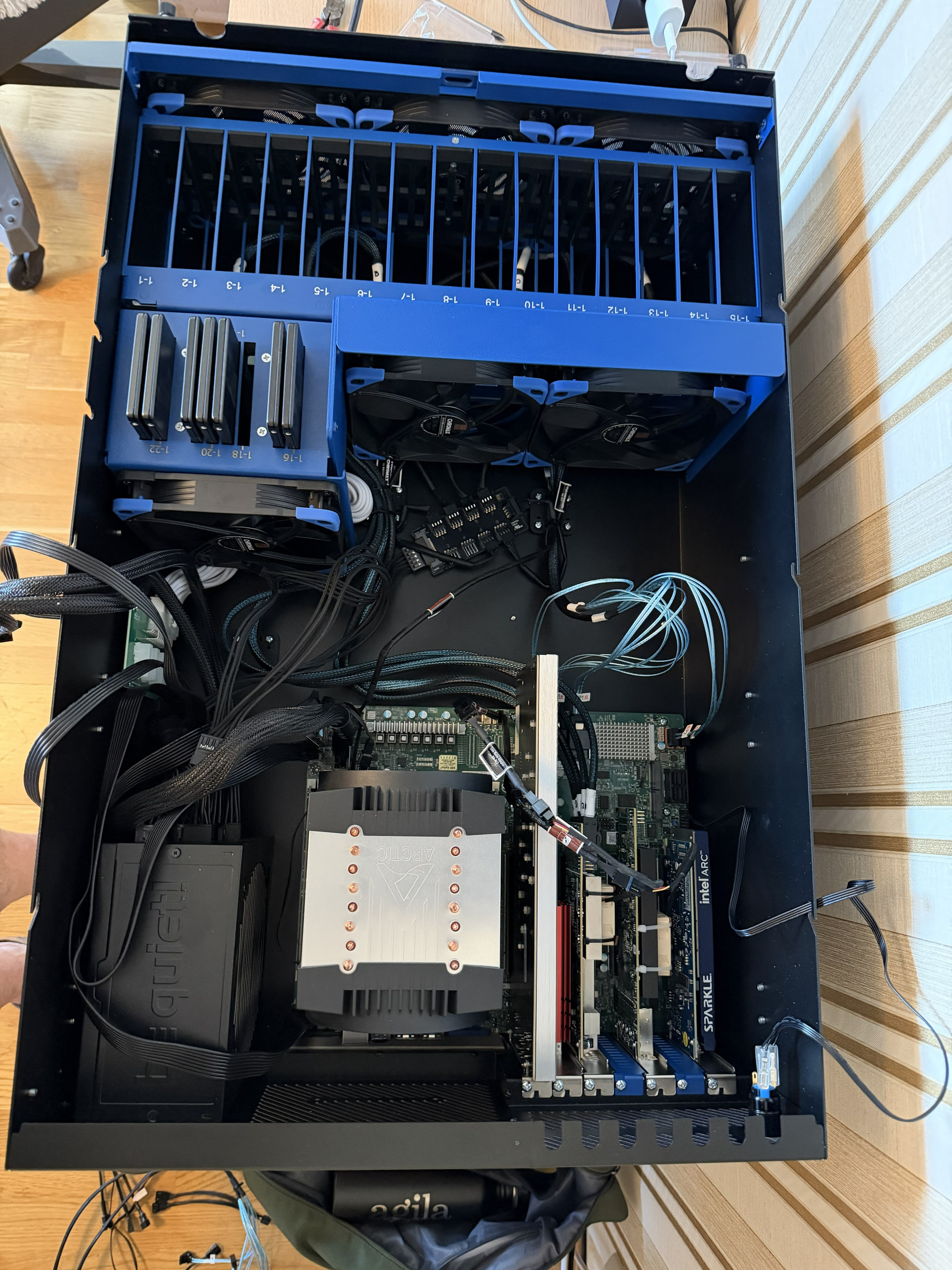

Finally it is running now!
I must say i am rather pleast with this chassi. I live in an apartment with no dedicated room for servers så my mission is to get it really silent. Due to the big noctua fans the server is really silent. The only problem i run into was i anoying resonance. But i fixed that with heavy rubber plates between the chassis and on top of the beast. I think it is the top cover that creates the resonance. The top cover is not stable enough, so it “sings along” with the harddrives.
I run a Supermicro H12SSL-C with an Amd Epyc 7F52 16 core with 256 gigs of Ecc memory. Around 450 Tb of storage (Jbod and the beast).
Really easy to build in, the only hickup was that the power to the ssd cage was not connected, took we a while to understand that!

Could you please confirm whether the PWM fan splitter shown in your photographs was included with the Beast?
Could you also explain how the SSD backplane is powered? You mentioned that its power was initially disconnected, and I would really appreciate knowing where it connects and whether it is powered through the main power distribution board.
I’m trying to understand the complete power arrangement before ordering my Beast and any custom PSU cables. I had already started another forum topic asking these questions before finding your excellent post.
Thanks again for sharing your build!
Alex
Hi Alex!
The fansplitter was included with the chassi. About the power to the ssd backplane? The power to the 3,5 inch backplane in the front is prewired with some white cables with connected to a small board with 4 pin molex. I assumed that those also powered the ssd cage. But as I found out there is a single 4 pin molex on the bottom/backside off the backplane of the ssd cage for power. So after I plugged one in everything started working.
Good luck with your build! I am still very happy with the beast. The sound is not bothering me and still the disks in both in the beast and in my jbod stays between 35 and 45 degrees Celsius under load.
