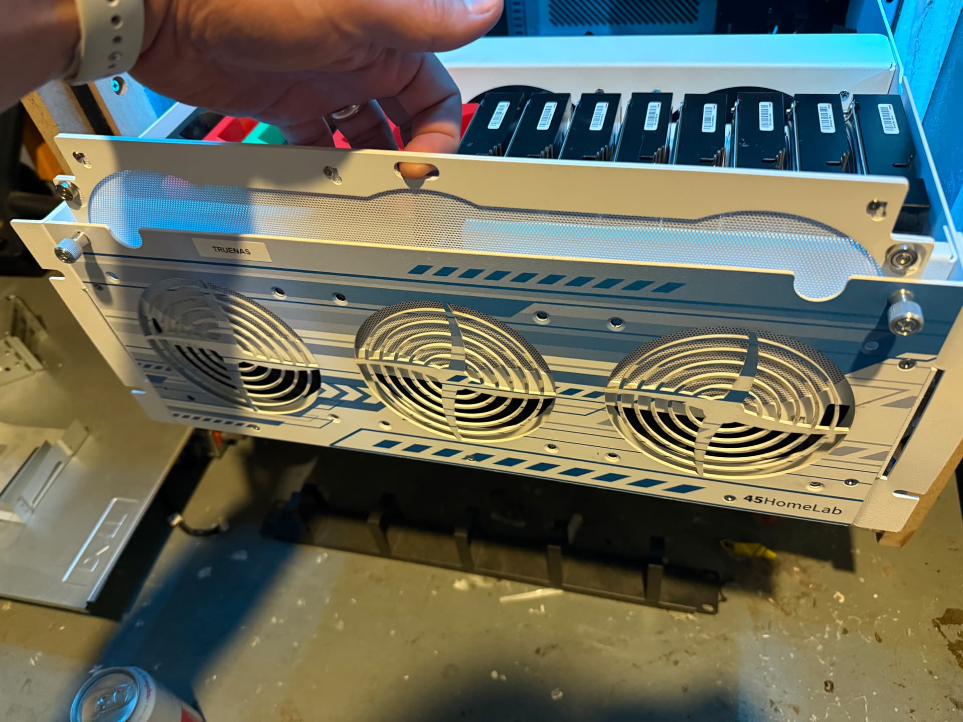

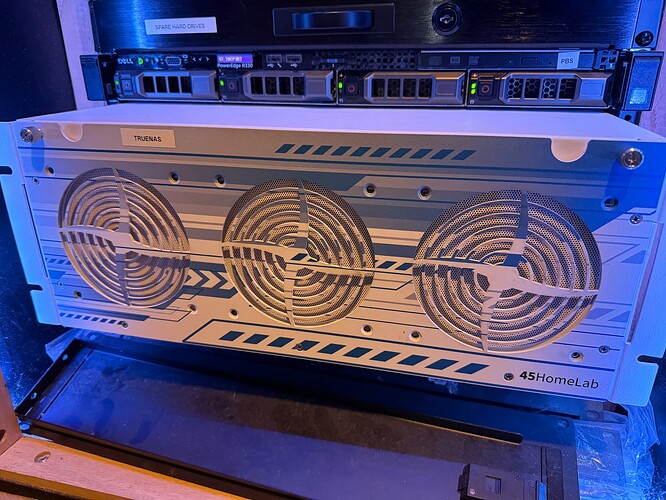

Today I installed the fan filter retrofit kit into my revision 1.0 HL15. It was pretty easy overall. I think I spent more blowing out all the dust ahead of time. Looks to me like the filter will get some good use. :sweat_smile:

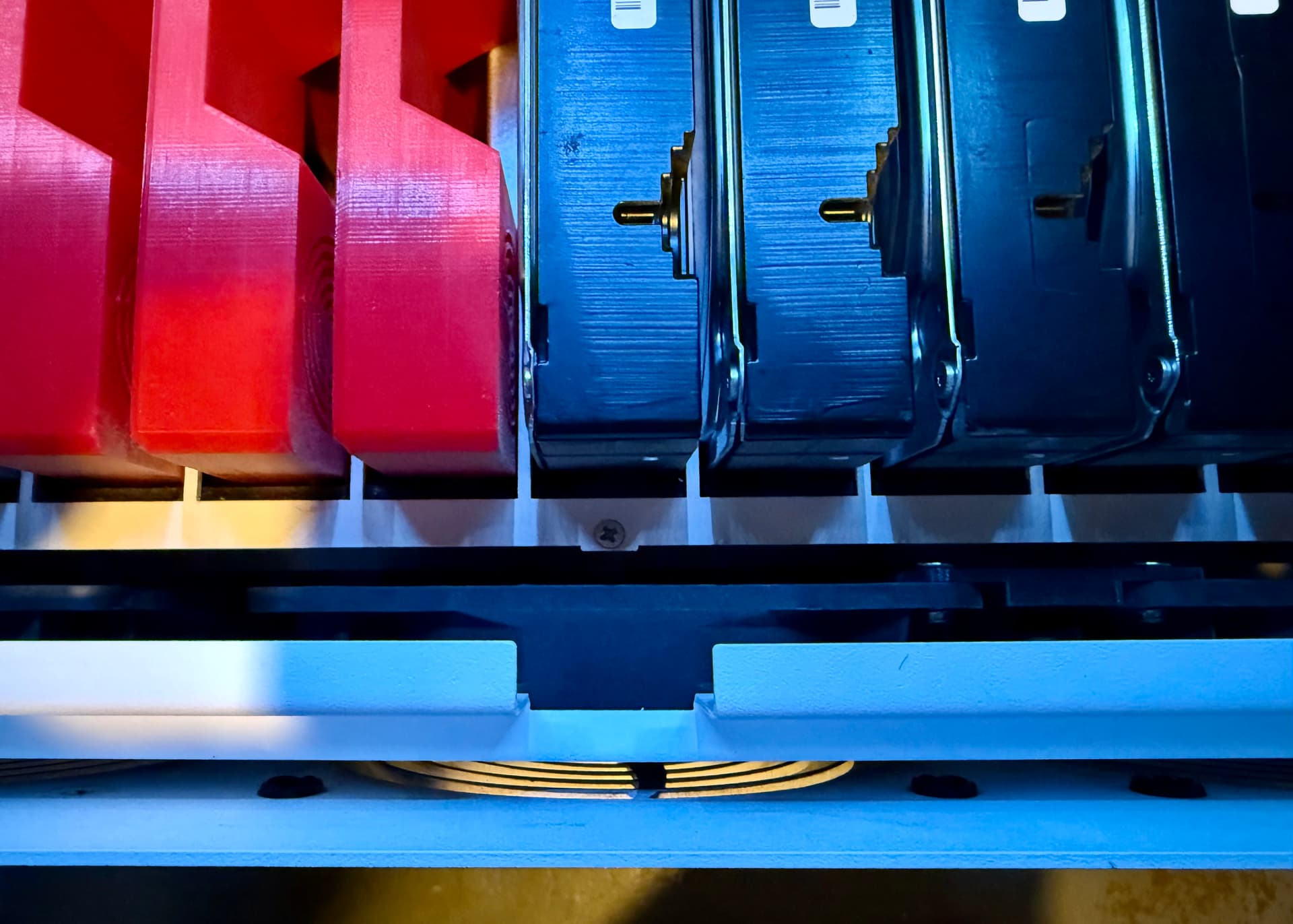

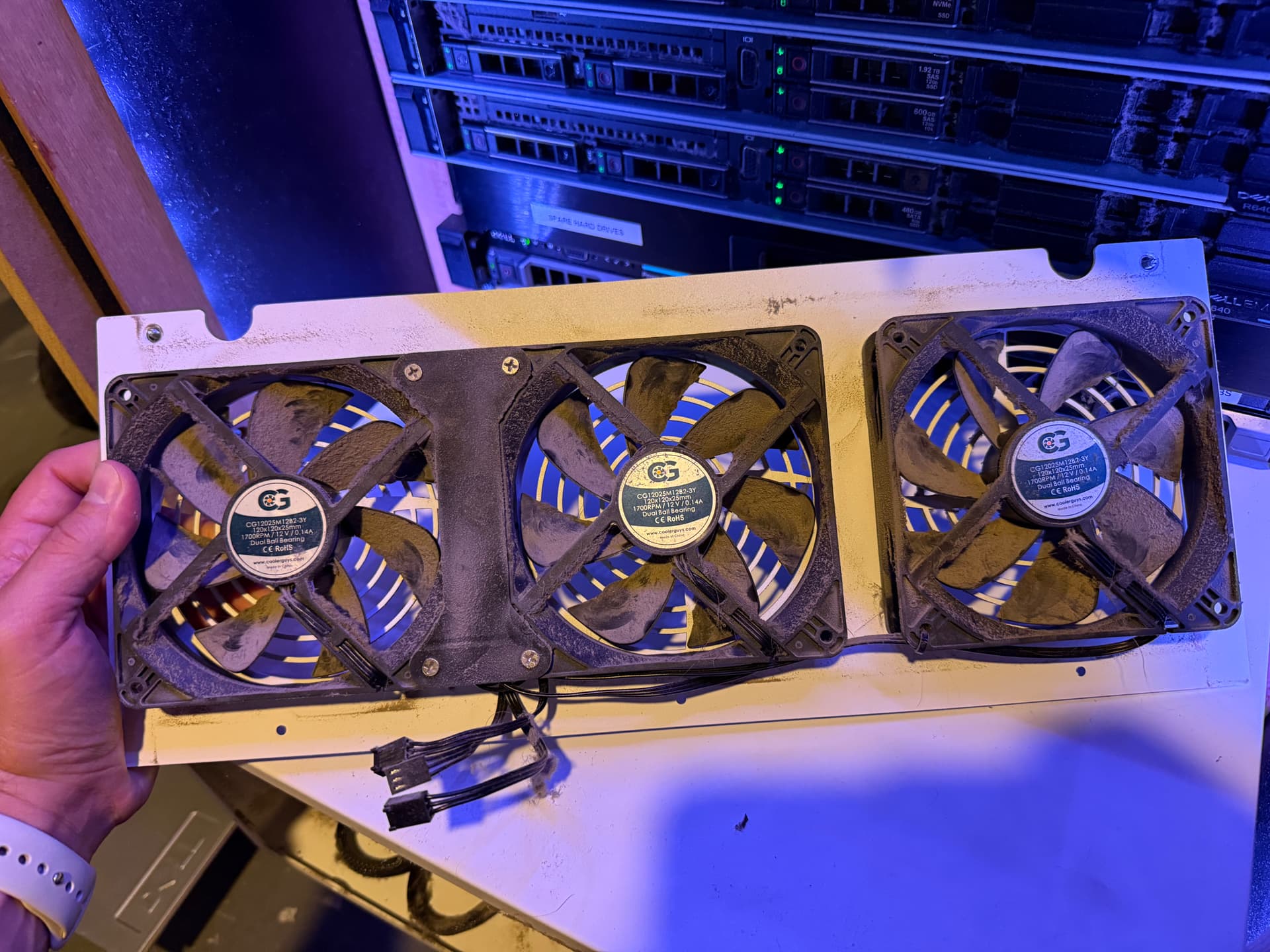

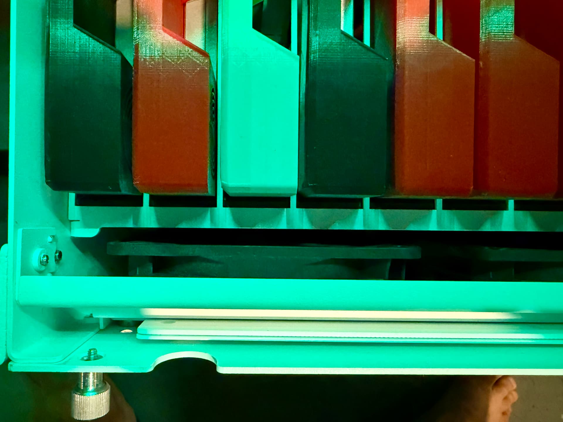

Sure - here’s a few more. The fans are moved back and attached to a new bracket that also replaces the top front support bar on original HL15 chassis. It’s tighter than before but still simple space.
thanks, might be about to fit my 38mm fans in there still. Notice it catching alot of dust? I was thinking of glueing really fine screen over the plastic mesh

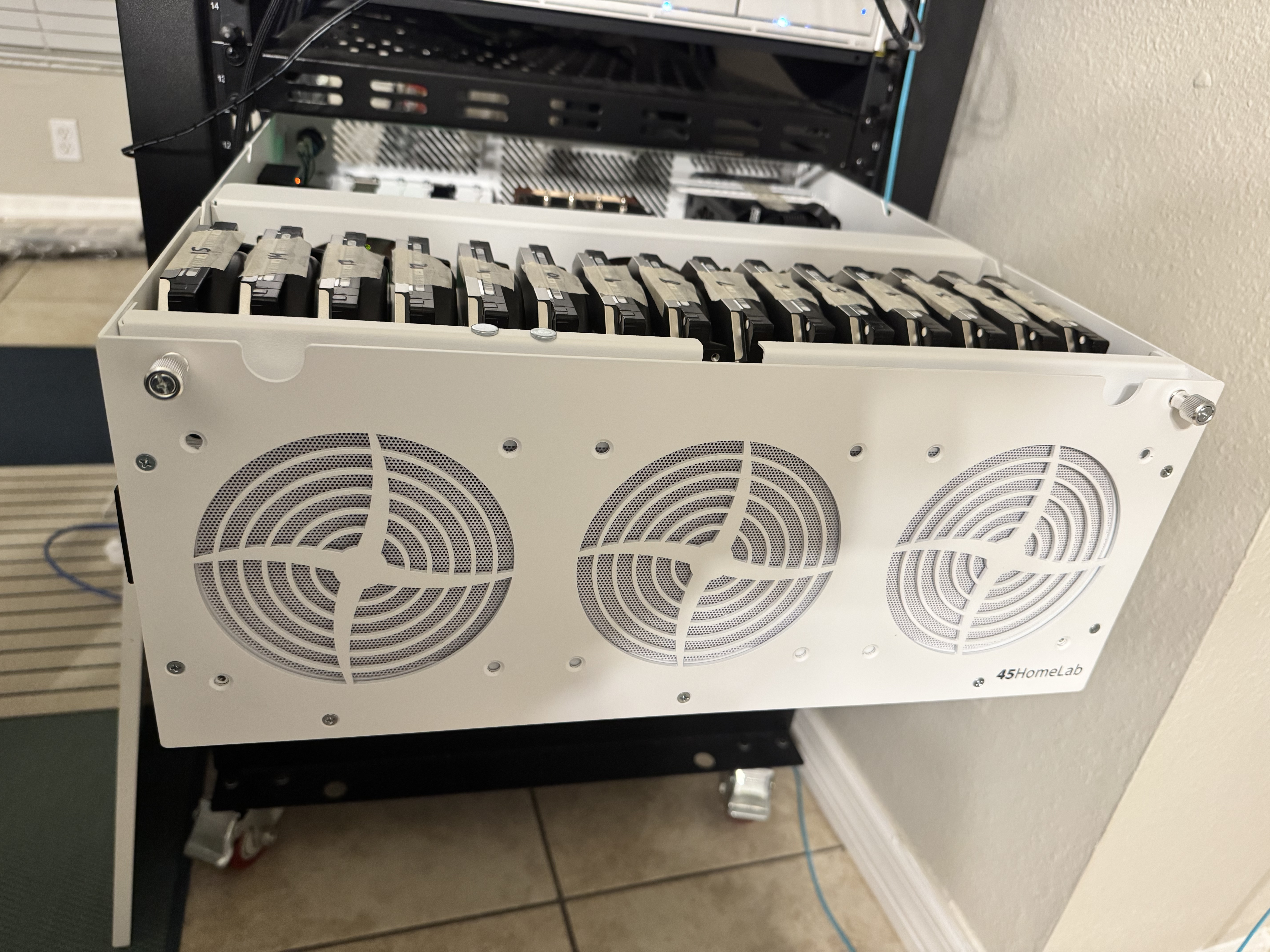

I also installed mine today on my OG White HL15 v1.0!! My only “complains” (not a real one), is the screw holes now that the fans are not directly mounted to the faceplate. Might 3D-print some caps in matte white and maybe blue for the top ones :smiley:
I was also thinking about 3D printing something for the screw holes.
Let me know if you find a good STL that fits well!
Same! I probably won’t have a chance to look until the weekend.

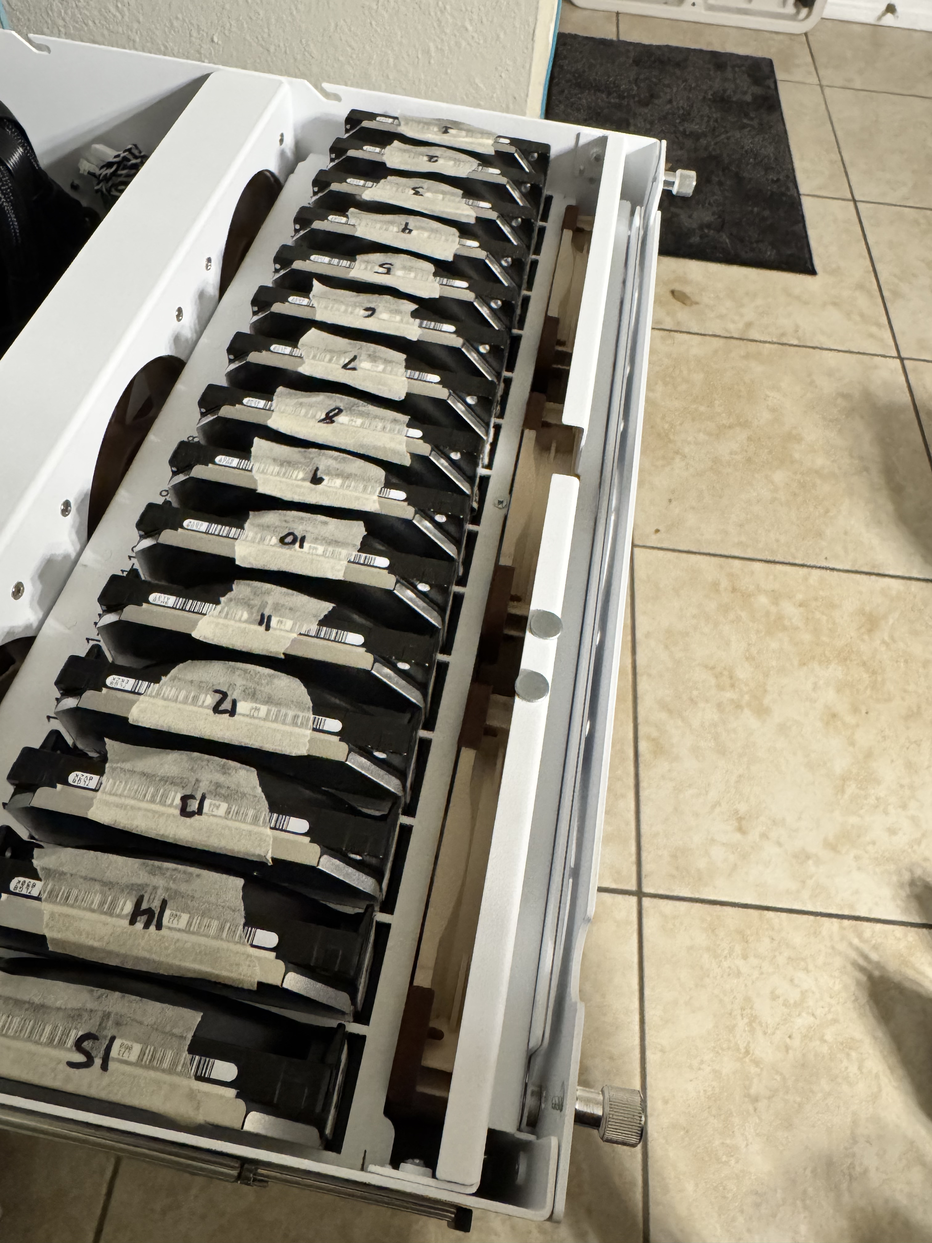

I want to say that I managed to install the retrofit filter kit with the Noctua inlet spacers and 25 mm thick fans.
I forgot to mention that I had to unscrew the 3d-printed fan cable holder, because the inlet spacer and the fan combined would prevent the fan holder plate to be fully inserted. This would not be needed if only the fans were installed like the upgrade manual assumes.
Thank you for posting this, I was just about to remove my Noctua spacers thinking they added too much bulk, but removing that cable holder did make it fit snugly.
Did anyone’s filter come with non-magnetic metallic “caps” over the magnets? I had to remove them to get the filter to fit on my HL15.
Here’s a view of the Noctua fans with spacers still installed.

@rymandle05 @pducharme did you try anything to plug the screw holes? I looked at various 5mm ⌀ plastic and rubber plugs, but I’m not sure that would look any better than the holes.
I’m thinking of getting some short M5 x 6mm screws and corresponding nuts. Although I might just save the money, as my servers aren’t on display.
I never did find anything. My server really isn’t on display either so it’s not the biggest priority for me either.
here is what @pducharme ended up doing with the faces
I did not plug the holes but got those nice custom faceplates:)
If one wants to use the filter, unfortunately it’s magnets line up with the top left and top right fan holes. I’m not sure how one would design a plug without some sort of protrusion on the back, and that would prevent the filter from sliding in all the way. There’s enough clearance in general given the few mm height of the magnets, but anything protruding through those two holes collide with the magnets as you try to lower it the last inch or so. At least on my unit.
