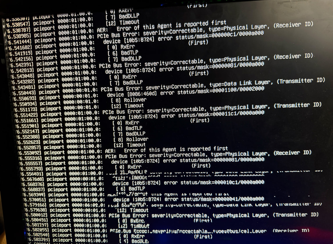

LSI 9300 16i PCIe Bus Error: severity Correctable pre kernel load
Some background: I am setting up a TrueNAS using a Rosewill 12 bay case, B760M Ultra Gaming MB (small but what I had) BIOS v F7 (Sept 2025), and a LSI 9300-16i. The first LSI we bought was DOA, returned it. Second one was plug and play, no issues. But, after sitting on its own for 3 weeks, the functioning TrueNAS was missing from the network.
The problem: The TrueNAS is rebooted and we see an endless looping of this error (apologies for the potato quality image):
Removed the cables from the card, same issue. Removing the card, server boots normally. Card back in with no cables, same errors.
Booting into BIOS we can see the card is there, and the system information looks normal. There are two LSI SAS3 MPT Controller SAS3008 devices showing in the BIOS Settnigs (as I understand it, that is what the 16i is), and the information showing looks normal. The green LED on the card is also flashing at about 1 beat per minute, which according to one The Art of Server video, means the card is powering up and the firmware is running.
Given this was functioning normally prior to the current state, I am at a bit of a loss on how to troubleshoot this further. Or is it perhaps just dead?
So the good news is the errors all look correctable so things are generally working despite the problem at hand with the reboots. The errors are either physical or related to low level operations. A few things to try:

Beyond what Ryan mentioned, here are some other things to try:
  • Force PCIe Gen 3 in the BIOS: By default, the Gigabyte B760M motherboard tries to run that slot at Gen 4 or Gen 5. Go into the BIOS and manually set the PCIe slot hosting the LSI card to Gen 3 (or even Gen 2, just to see if the errors stop). This widens the signal margins and often cures AER floods instantly.
  • Add Active Cooling: If the card is still alive, it may need a dedicated fan. Try zip-tying a 40mm Noctua fan directly to the LSI heatsink.
  • Bypass AER to check functionality: To confirm the drives and TrueNAS are actually fine, interrupt the GRUB bootloader and add pci=noaer or pcie_aspm=off to the kernel boot parameters. This tells Linux to ignore the hardware retry noise. If the system boots and the storage pool imports, the issue is strictly PCIe communication logging and not dead SAS controllers.

Ryan:
  • Card has been carefully inspected and reseated… several times, no change.
  • BIOS settings I mucked with and rest 2 times now, no change.
  • LSI firmware version - this is one area I have not looked at but will. Since I do have another LSI card coming, I feel comfortable attempting a firmware update even if I destroy the card. Best way to learn :slight_smile:
David:
  • The heat issue and thermal degradation sounds reasonable in this case, as the card was fine for the first day or so, and at some point during it’s short uptime life, these messages started.
  • Signal Integrity, I did not know this, but it does make sense to me.
  • The cables are well supported so no weight there, but good tip for all my wiring. This is my first build in almost 20 years. One forgets a lot over time.
  • Force gen3 or gen2. Based on another thread maybe on Reddit, someone suggested this but I was not able to find the setting. I will look again.
  • Active cooling, definitely going to do this, I think I have a fan somewhere, and I will look into getting something beefier. The rack is where I can’t hear it, so noise levels should not be a problem.
  • Bypass AER - I dd both of these suggestions and was able to get the machine booted and running! This is wonderful, thank you!

1. The BIOS Fix: Disable ASPM and Force Gen 3
The most common root cause of these correctable AER floods is an incompatibility with ASPM (Active State Power Management). ASPM is designed to save power by putting idle PCIe links to sleep. However, older enterprise LSI cards absolutely hate consumer motherboard ASPM implementations. The motherboard tries to put the PCIe switch to sleep, the LSI card doesn’t wake up in time, packets drop, and the AER loop begins.
To fix this permanently at the hardware level:
  • Disable ASPM / Native PCIE Enable: Go into the motherboard BIOS and look for settings related to PCIe Power Management, ASPM, or “Native PCIe Enable.” Force them to Disabled.
  • Force PCIe Gen 3: While in the BIOS, manually set that specific PCIe slot to Gen 3 instead of Auto.
2. The Physical Fix: EMI Shielding and Slot Reseating
If disabling ASPM in the BIOS doesn’t stop the underlying noise, you might be dealing with physical signal degradation (EMI interference or poor contact).
  • Clean the Contacts: Take a pencil eraser and 99% isopropyl alcohol and clean the gold PCIe contacts on the card.
  • Change Slots: If possible, move the HBA to a slot further away from the GPU or power supply. The LSI’s unshielded PLX chip might be picking up electromagnetic interference from a neighboring component.
3. The Software Fix: Make the Boot Parameter Permanent
If the hardware and BIOS tweaks fail, but the card runs flawlessly under load with the errors suppressed, there is no harm in simply telling the Linux kernel to permanently ignore the noise.
In a TrueNAS SCALE environment, you shouldn’t edit the GRUB bootloader files directly via the command line, as system updates will overwrite those changes. Instead, make the kernel parameter permanent through the middleware:
  1. Navigate to the TrueNAS SCALE Web UI.
  2. Go to System Settings → Advanced.
  3. Locate the Kernel Command Line Arguments section.
  4. Add pcie_aspm=off (disables the problematic power management entirely) or pci=noaer (just mutes the reporting).
  5. Save and reboot.

This was the change I made to stop the noise. Added it to /etc/defaults/grub or there abouts.

Before we make assumptions, in Truenas go to System \ Shell and run the following command;
sudo dmesg | grep -i mpt3sas
You should get some output that includes lines like this:
[    3.500036] mpt3sas_cm0: LSISAS3008: FWVersion(16.00.10.00), ChipRevision(0x02)
[    3.500039] mpt3sas_cm0: Protocol=(Initiator,Target), Capabilities=(TLR,EEDP,Snapshot Buffer,Diag Trace Buffer,Task Set Full,NCQ)
[    3.500954] mpt3sas_cm0: sending port enable !!
Yours will likely show this twice, once for each of the SAS3008 chips on the 9300-16i. Does it say Protocol=(Initiator,Target) or just Protocol=Initiator?
Output is:
[    4.209117] mpt3sas_cm0: LSISAS3008: FWVersion(07.00.01.00), ChipRevision(0x02)
[    4.209125] mpt3sas_cm0: Protocol=(Initiator,Target), Capabilities=(TLR,EEDP,Snapshot Buffer,Diag Trace Buffer,Task Set Full,NCQ)
[    4.541116] mpt3sas_cm1: LSISAS3008: FWVersion(07.00.01.00), ChipRevision(0x02)
[    4.541123] mpt3sas_cm1: Protocol=(Initiator,Target), Capabilities=(TLR,EEDP,Snapshot Buffer,Diag Trace Buffer,Task Set Full,NCQ)
Based on my research this says the card is in IT Mode. Is that correct?
I should ask, is there anyway to install lsiutil on the TrueNas box? Most of what I have read says no. apt is disabled which means no apt install and no build tools. It would be nice to get the temp of each chipset.
Yep it’s in IT mode but the firmware is really old. You can download a Linux x64 binary of lsiutil and run it on truenas. That’s what I’ve done in the past. I believe Broadcom has it on their website somewhere. Sadly they don’t necessarily make it easy to find. Might be better off finding a forum link to it.
I agree with Ryan, you have IT mode firmware, but if you intend to keep the card you want to upgrade it to 16.x. You can get 16.00.10.00, which is the version AoS will probably load on your new card from Broadcom here;
Or there was a hotfix specifically for Truenas released as 16.00.12.00 here;
