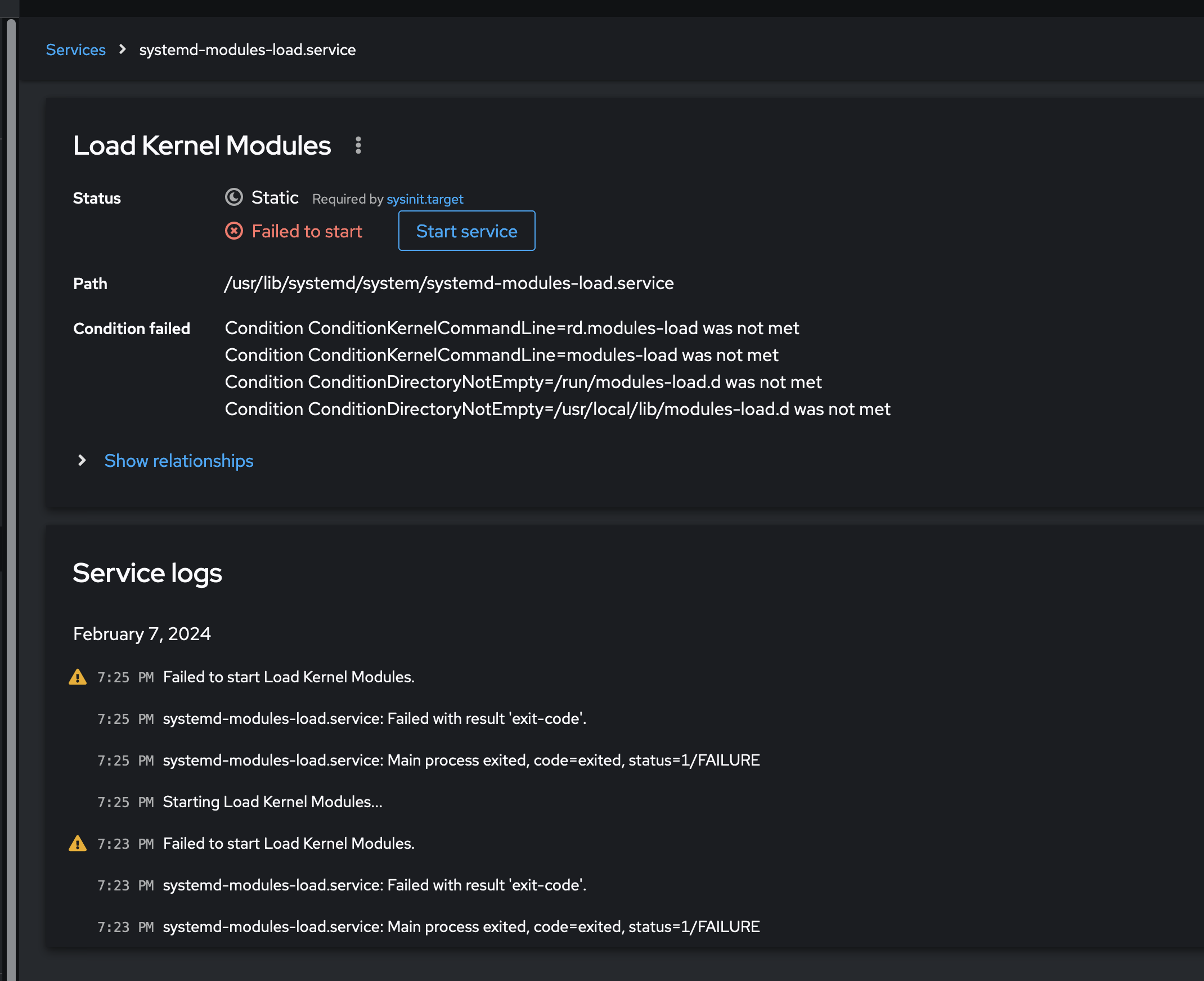

I just received the HL15 (fully burned in), powered it up, got into Houston and there was an error with the Kernel Module Service. Did some digging around and can’t really find anything that works. Didn’t see anything in the forums either. Wondering if you can help. This is a brand new system with no config on it yet.

Ok. Getting a little closer. Running journalctl on that PID i get back the following:
[45drives@hl15 ~]$ journalctl _PID=702
– Logs begin at Thu 2024-02-08 08:55:49 AST, end at Thu 2024-02-08 09:50:19 AST. –
Feb 08 08:55:52 hl15 systemd-modules-load[702]: Module ‘msr’ is builtin
Feb 08 08:55:52 hl15 systemd-modules-load[702]: Failed to find module ‘zfs’

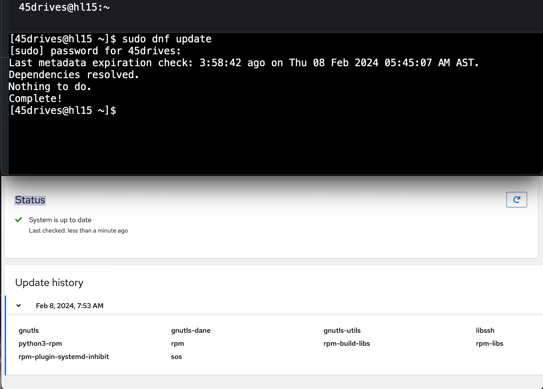

So I got home this morning. Sat down for a min and logged into the hl15. Seems like it fixed itself. There must have been an update while I was away. Ran an update again and everything is updated and everything seems to be working.
