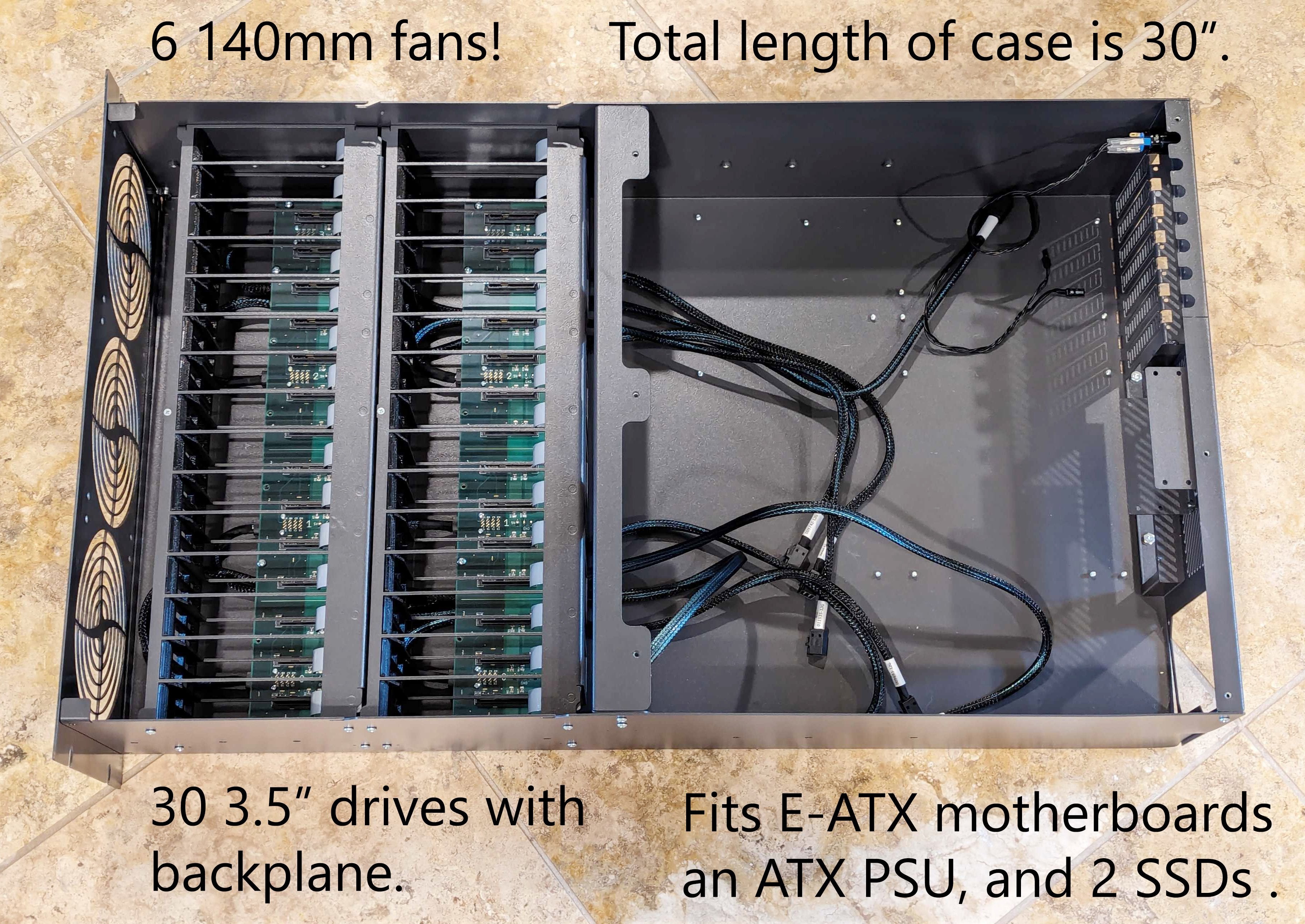

I know “The Beast” is coming, so it’s somewhat moot, but I somehow stumbled across this post on the interwebs;
Seems at least one EATX Q30 was made, although perhaps with more involvement on the Protocase side than the 45Drives side. Notes say it was later sold on eBay.
Ya I was looking at the auction when it was there, chassis sustained shipping damage and was in Hawaii. so it was not in great shape and fortune to ship probably.
Sure. I guess my point was that the super secret password is apparently Protocase.
