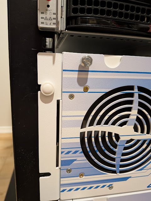

You secure the equipment in the rack using cage nuts or studs on the front. Your rack should have come probably with some nuts and bolts. The SM rails themselves don’t lock open or closed. I got some thumbscrews similar to the ones used to release the top on the HL15 so I could secure and unsecure my servers by hand and not need a screwdriver. (rack studs would also do that).

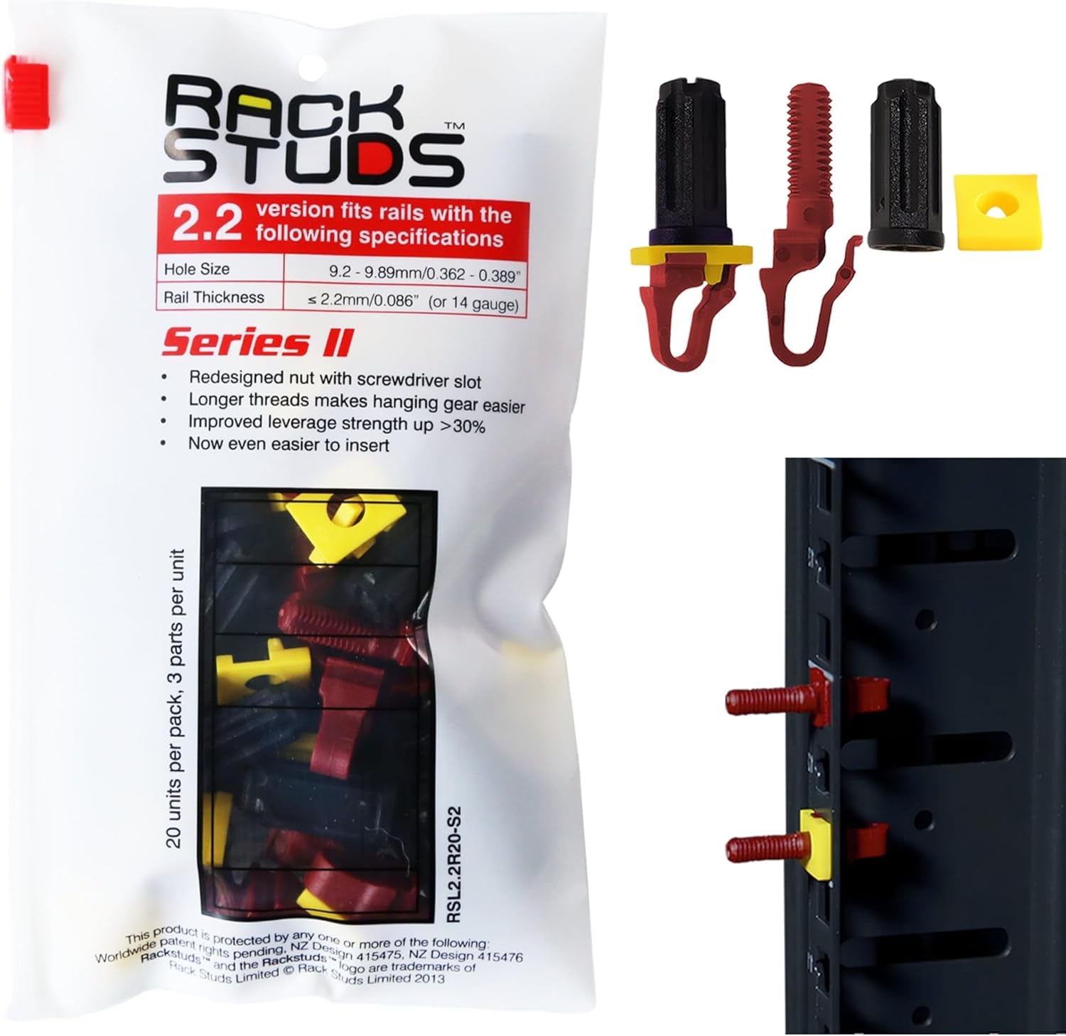

Rack Studs can be inserted from the front if you can’t easily place new cage nuts.
