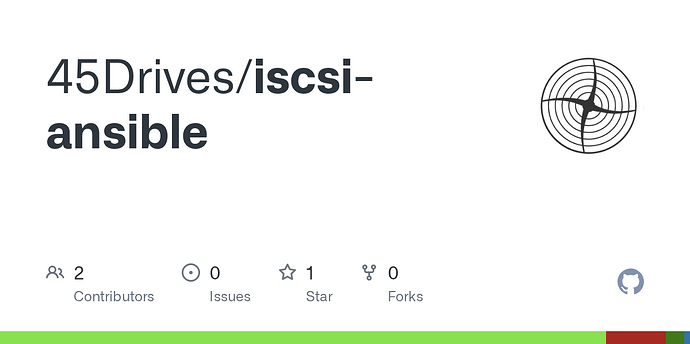

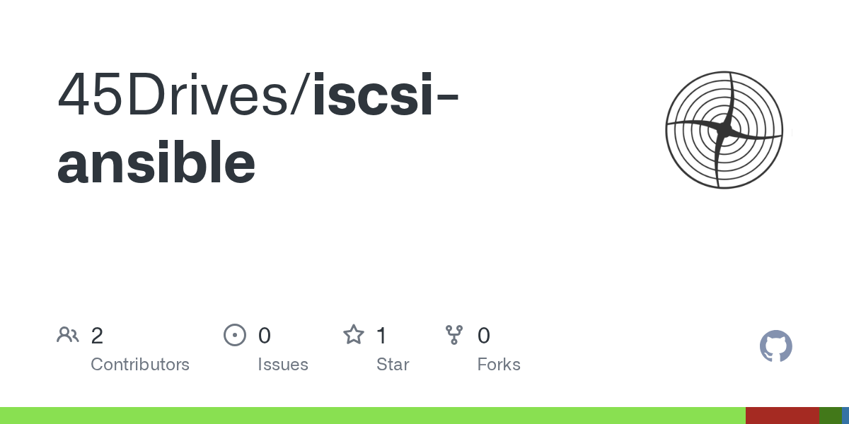

At the moment, installing the SCST iSCSI module requires running an Ansible playbook. This is necessary because SCST is compiled from source and requires additional components that are not included in the standard file-sharing configuration.
Once the playbook has been run and SCST is active, all further configuration can be completed directly from the File Sharing tab.
You can find the playbook here:
Please let me know if you have any questions or need any assistance with the setup. I am happy to help.
