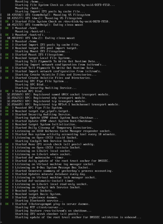

HL8 did a update over the weekend and hangs at boot
Looks like my NAS did a update over the weekend and now is hanging on boot
Been stuck at this point for over a hour
Well that’s not good. Sorry to hear you’re having issues. Did anything more ever spit out? I can’t tell which distro you’re running (assuming Rocky), but Ubuntu or Debian will usually kick out some kind of “waiting” message after some time. Chances are whatever is left waiting is either your culprit or at least related/dependent upon it.
Regardless, you’re going to need a different way to access the system to fix any problems. If you can access the grub boot loader menu a lot of distro’s have a “rescue” or “recovery” boot option which will load only the basics and drop you into a prompt. This is also called “maintenance” or “single user” mode. If you don’t have premade option, then you can find your way there by changing the bootloader options. This article does a good job walking through that.
How to Boot into Single User Mode in CentOS/RHEL 7
A live distro environment can also work from a USB drive. There are even some designed around fixing broken operating systems like https://www.system-rescue.org/.
I got it fixed it was the JetKVM that I was testing. it looks to be back feeding power into the USB unpluged it and it boot just fine. Thank you guys so much
