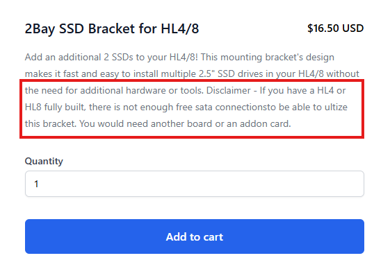

Can’t he use the optional SSD bracket?
For mounting the drives without taking up slots this would work, but he’s still coming up short on SATA connections to have 8 drive bays plus two more SSD’s for the OS (total of 10). That said, a PCIe SATA card would be another option to get more SATA ports to accommodate the setup he seems to be looking for.
