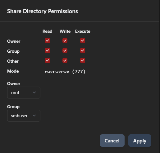

Could you jump in the terminal and run “ls -al /tank” this will give us what permissions are set
You can also do this in the navigator by going to the /tank directory and looking on the right-hand side

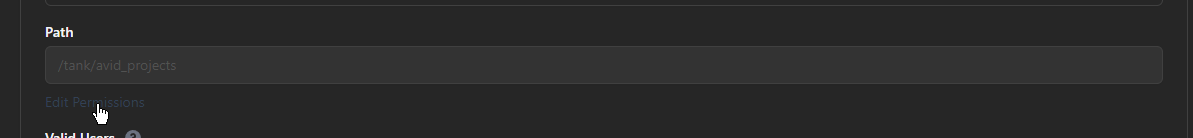

You can also check this under the share path in the filesharing tab here
It will bring up a window like this
Hutch
I matched the setting above and I still can only view the share in Windows but can’t access the directory to make changes.

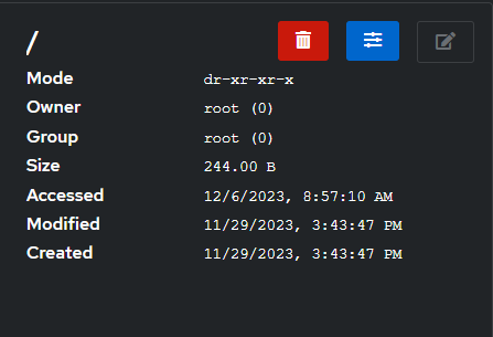

What would be the permissions above and below that path?
If you use nagivator does it show 777 on the above and below?

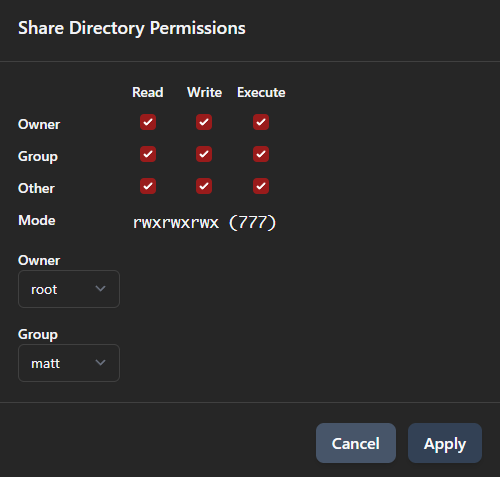

SELink is disabled, I have tested with the local user which was added to smbuser group as detailed in the manual.
What are your permissions on your /tank and your/tank/share? It should be owned by root:smbuser and be 770 for you to have read and write and execute access.
