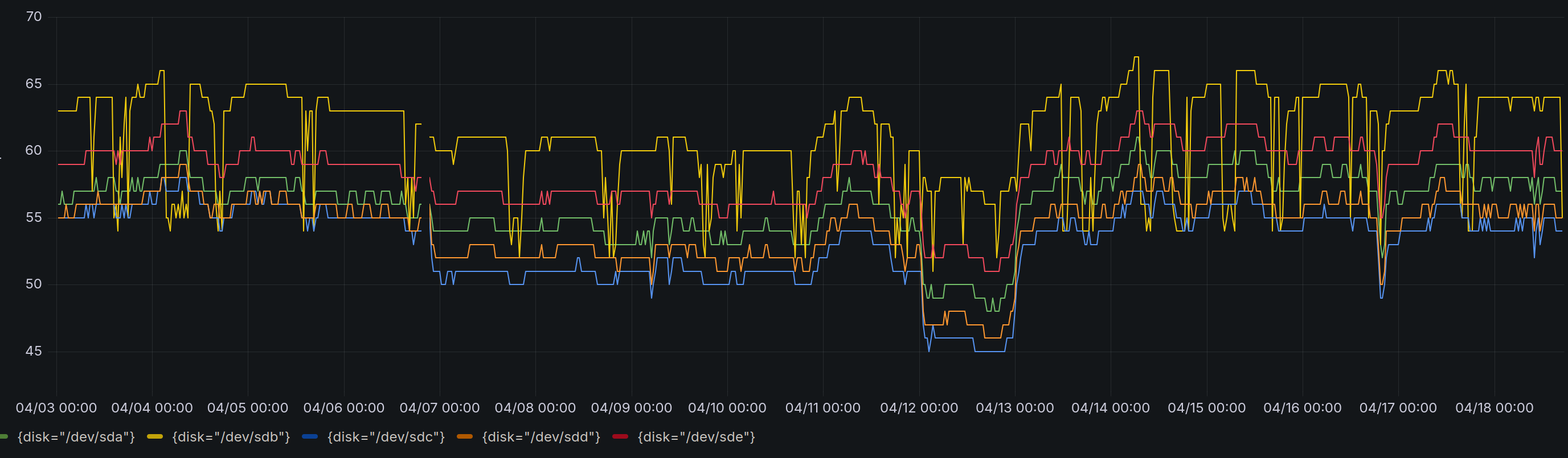

The Jonsbo N5 is what I’m using now and the airflow over the drives is so bad I’m questioning whether anyone who recommends it has actually used it.
Lower temps on the chart below correspond to colder temps outside. Units=Celsius
