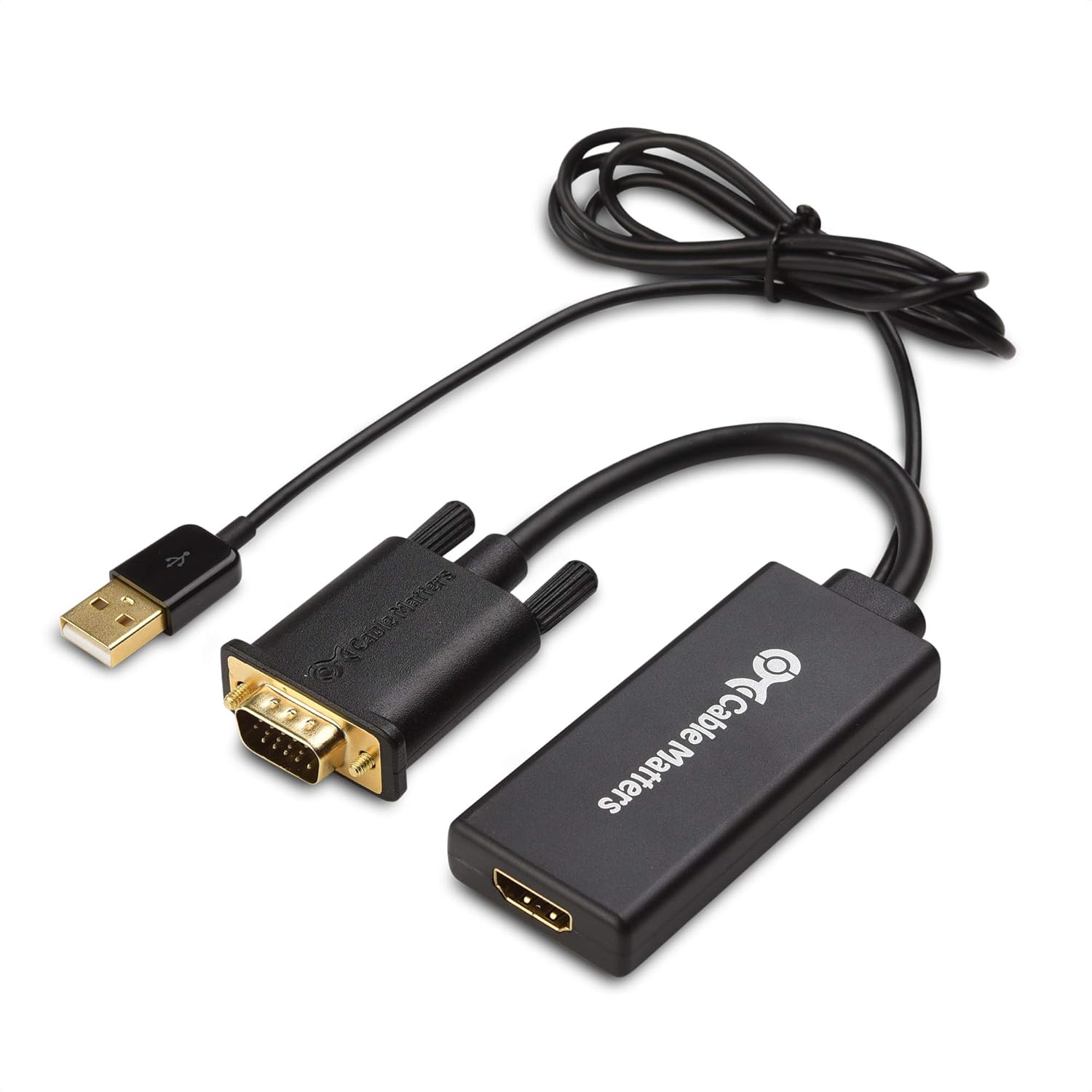

You can add a VGA-to-HDMI adapter to your toolbox. I use this one with old Supermicro motherboards;

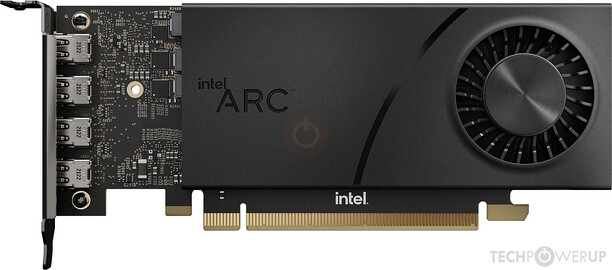

The spec for the power delivery from the PCIE slot did not change from PCIE 3 to PCIE 4, 75W. The A310 has a maximum draw of 30W. The A380 does have an 8-pin connector, but its maximum draw is 75W.
https://www.techpowerup.com/gpu-specs/arc-a380.c3913
It looks like the H15’s now ship with 1000w PSU’s but 75W vs 30W makes me want the A310 instead. I’m not going to be gaming on it. Thanks for the references. I’m hoping it will work fine in a TrueNas Scale/App container (docker). Guess I’ll find out soon.
