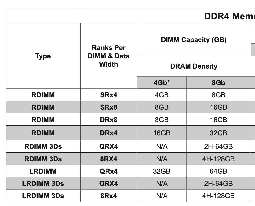

Oh, that’s a very interesting difference.
the memory configuration guide shows that for the first-gen CPU that I’m talking about is QR4
They’re only free if they work :slight_smile: otherwise they’ll stay in the server they’re currently in…
@rymandle05 I totally missed the context of your comment! I thought that you were saying mine was the dual rank vs quad. If yours works then mine should. It’s exactly in spec as a 64GB LRDIMM QRx4!
