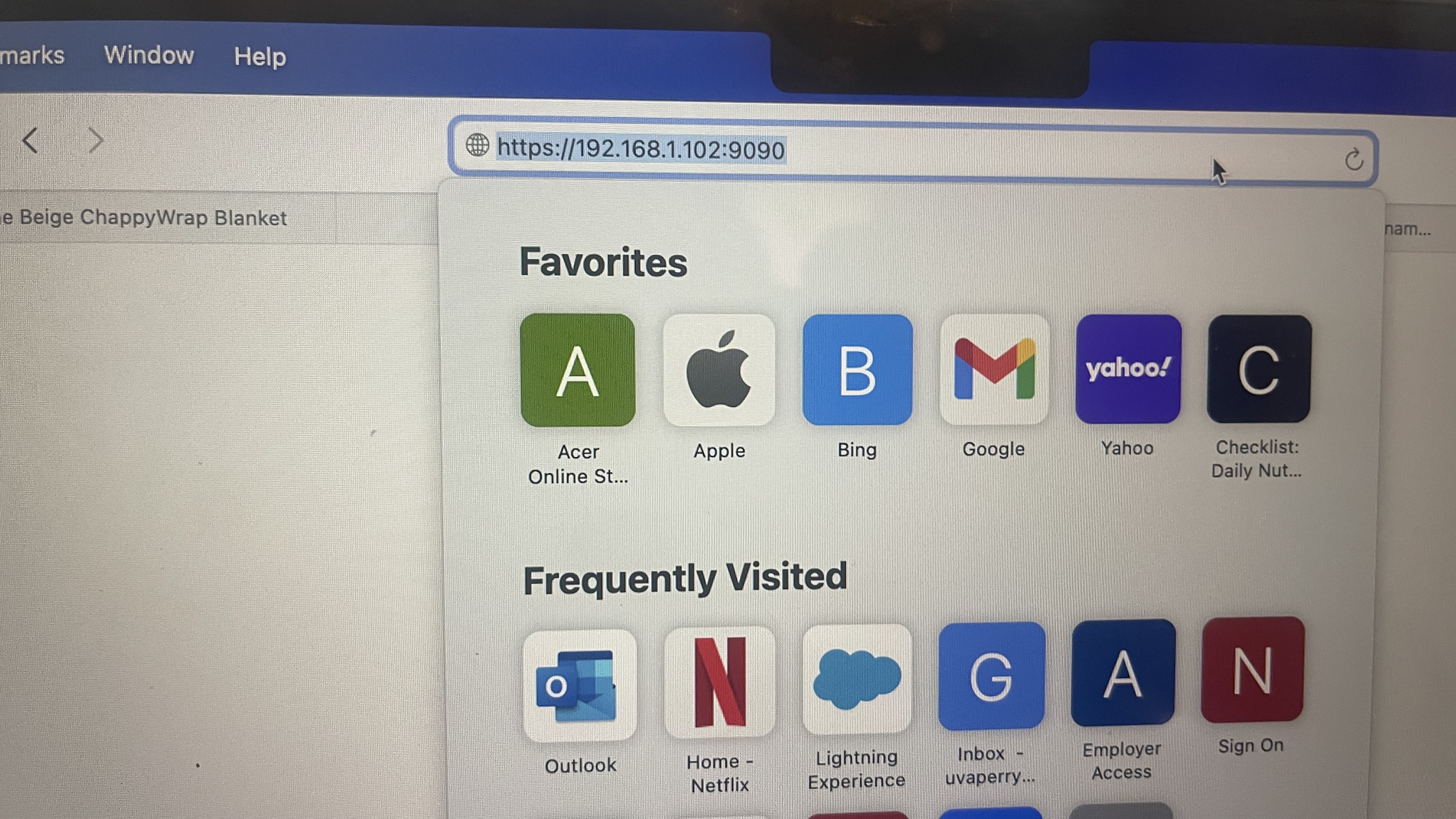

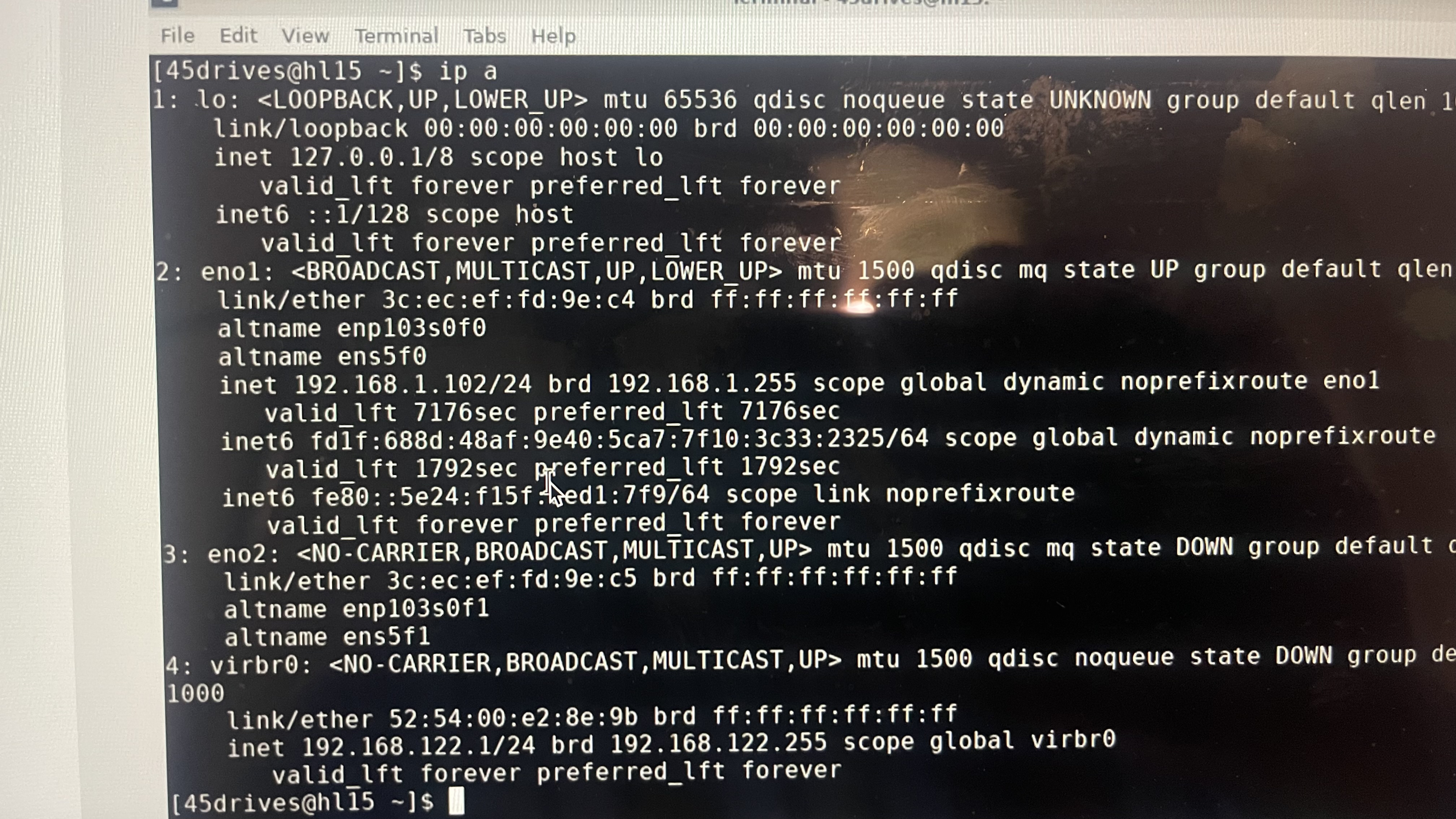

Hello
I have gotten into the ipmi, determined my up address, but when I go to the ip address https://192.168.1.102:9090 I am getting site not found. Is Houston not installed. I am not familiar with rocky so not sure where to look for installed packages.
I have tried using both ports on the motherboard. And the different addresses to no avail

make sure firewalld is not blocking 9090 or disabled.
I had an issue with that as I did not know that firewalld was configured.
