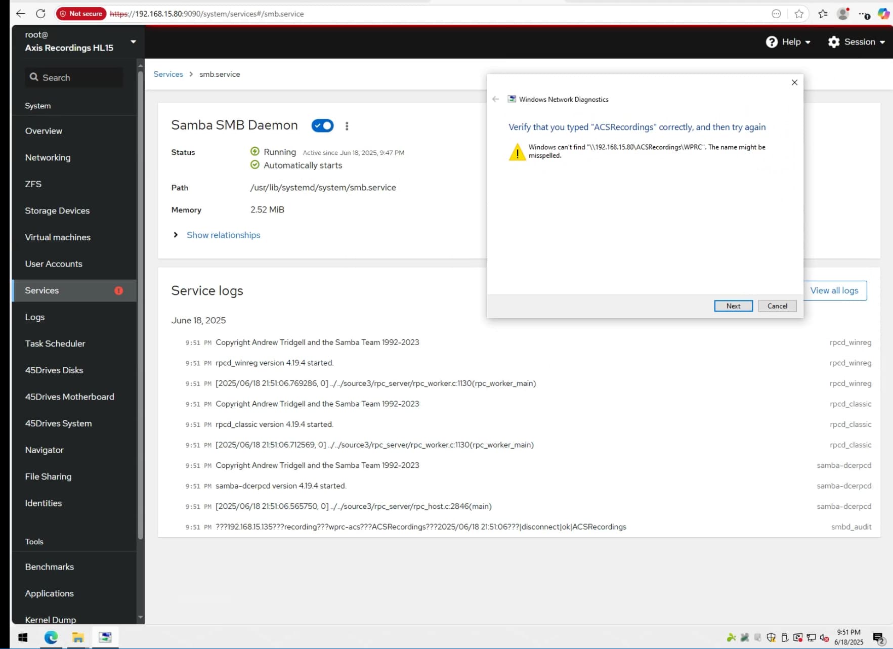

I also had it connected to the Axis Server as a storage location directly from cameras. However, after a restart it lost connection and it now refuses to reconnect. Says it cannot find the share even though nothing has changed. All services are running. It took 2 hours of entering the same username and password as well as \address\share and then miraculously just worked… the first time it was set up

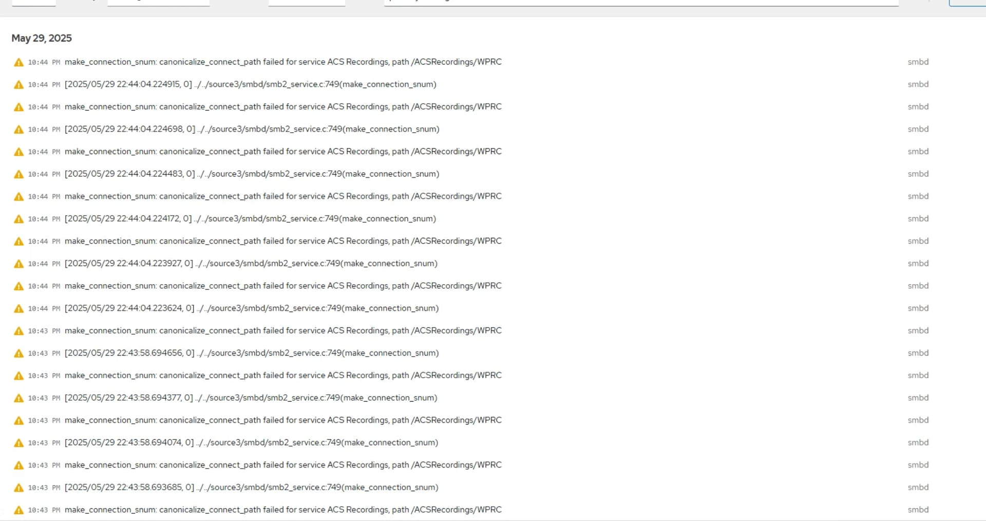

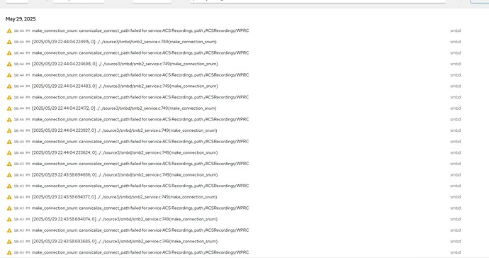

See photo for the errors recieved.

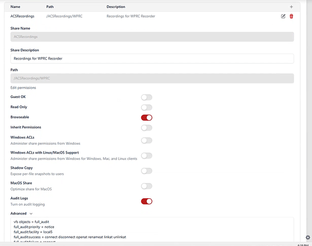

Do you mind sending over the SMB config?

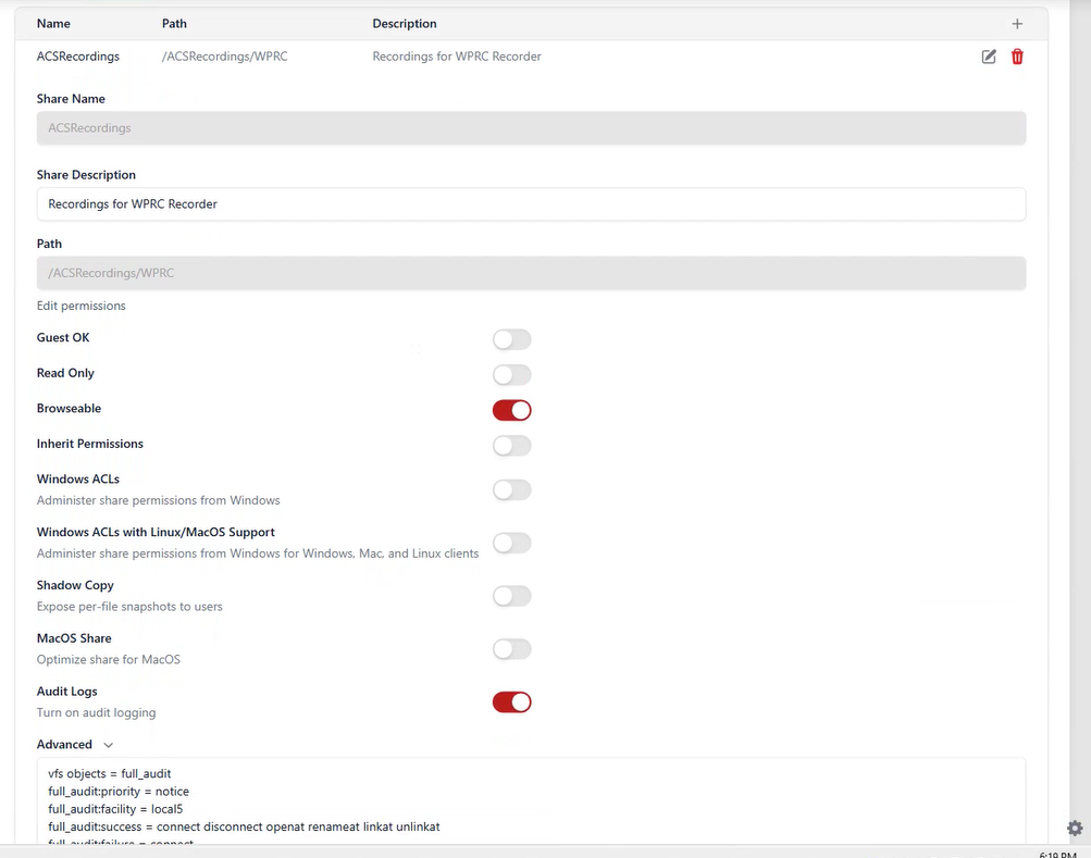

Hi @AlexD,

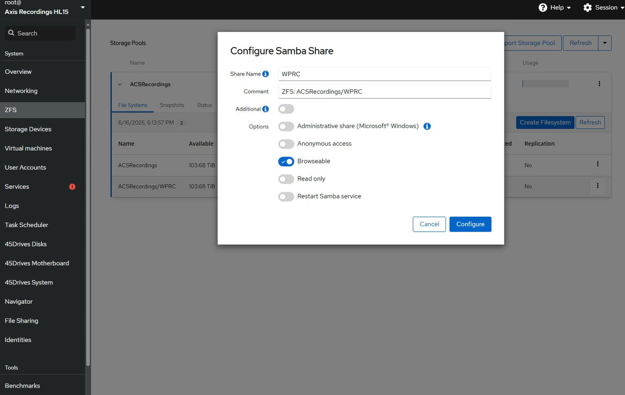

Thank you for sharing the screenshots; they were very helpful. Based on what you’ve provided, it looks like there’s a configuration conflict involving your SMB shares.
It appears you have an SMB share defined in both the ZFS tab and the File-Sharing tab. We strongly recommend against using the SMB share option within the older ZFS tab, as this can cause unexpected behaviour. The latest 45Drives ZFS implementation has removed this option in favour of using the dedicated File-Sharing tab.

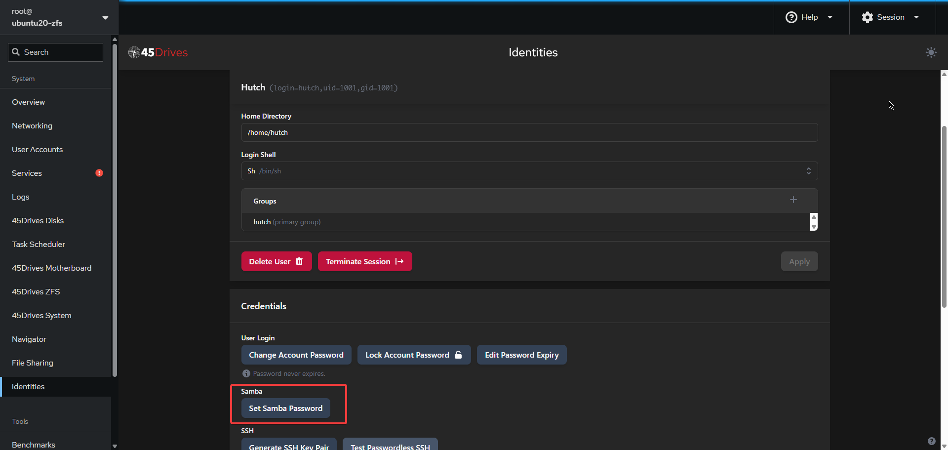

So when you create a user in Identities, it will ask you for a password. This password is for the Linux user themselves and is not used for SMB.
Once the user and password are set, there is another option in the user’s settings to add an SMB password
This is where you want to set the SMB password for your user.

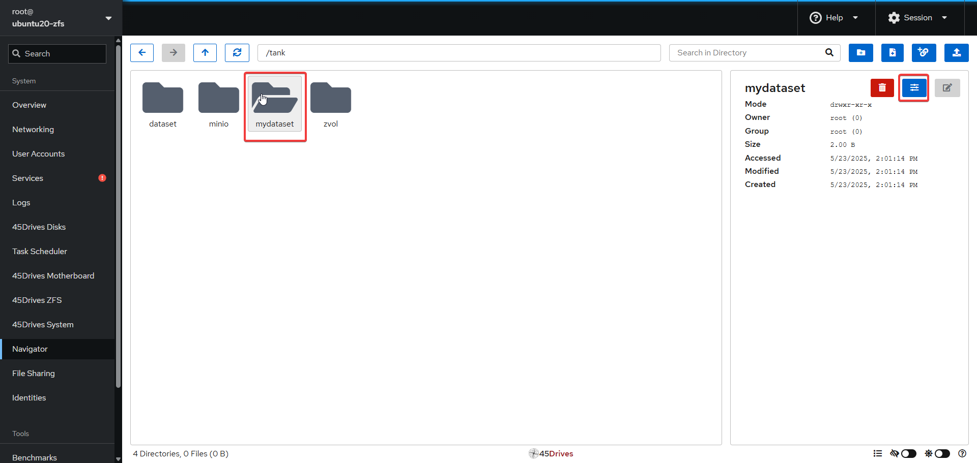

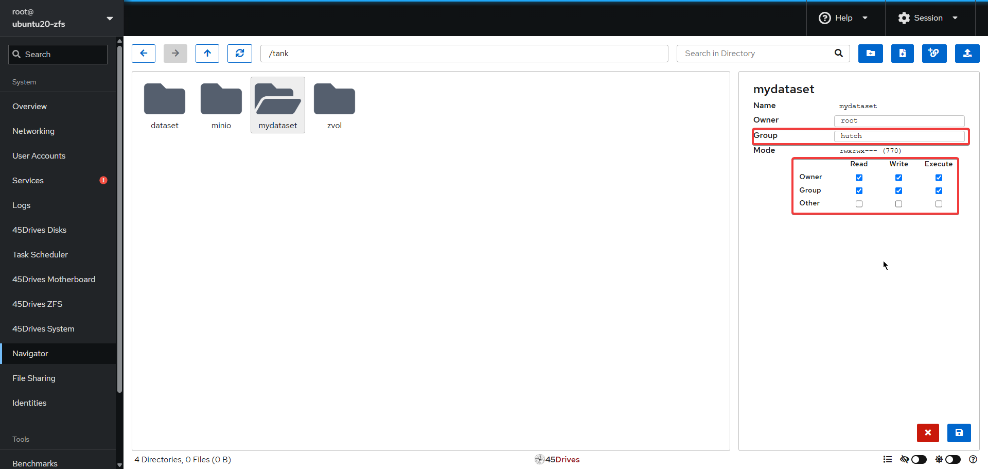

To do this, you will want to go to your ZFS pool in Navigator and find your Filesystem/Dataset you created (NOTE: if you did not create one, go back to the ZFS tab and do so first)
Now, change the permissions of the filesystem like the image below
Now you should be able to provide your user name and passwords to connect to your share

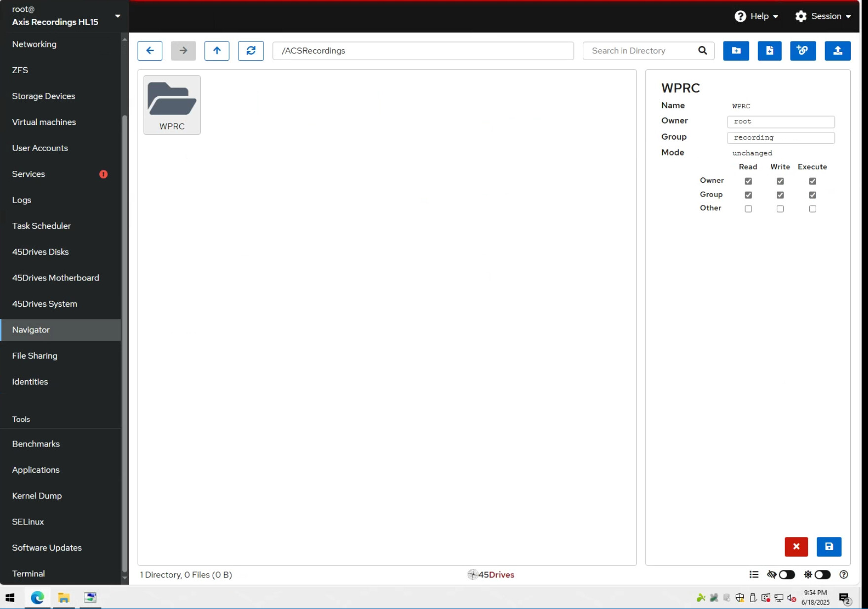

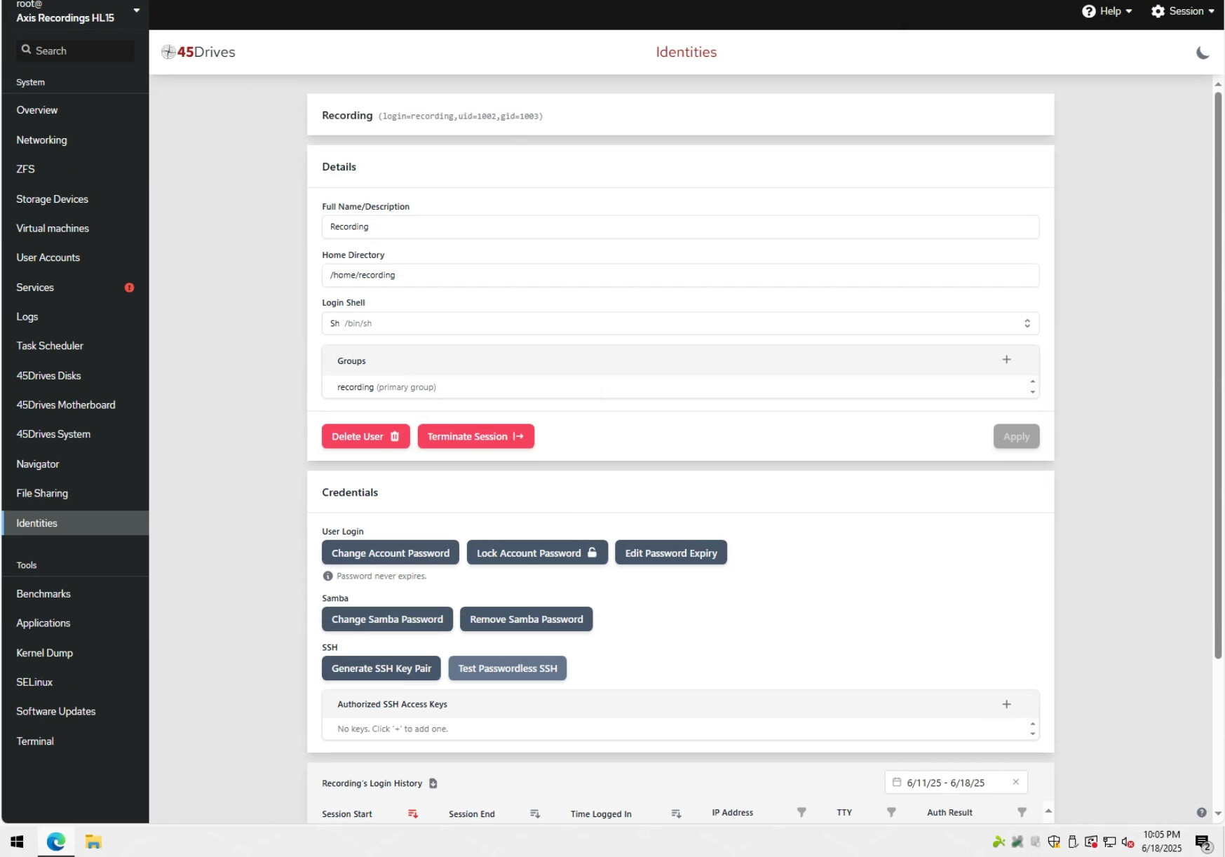

Hey Hutch, I tried all of the above, i ensured that the group had permissions in the dataset. I even tried changing the user to owner. See screenshots. Sorry for all the back and forth.
Note on the last image it fails to connect and the SMB service restarts.
I will also attach a copy of the user below
the only thing that was different was the login shell which i changed to match the one you sent. Previously was /bin/bash/

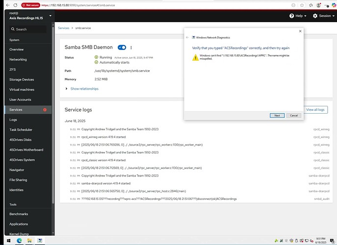

No connection on the direct IP. Network port issue?
Hey @AlexD, since you can not get to the IP, it is likely a network or service issue and not a permissions issue.
Let’s first start with making sure the firewall is off on the server and try to reconnect to the IP as @Braeden-45Drives suggested.
If you then get a prompt for a login in we know that SMB needs to be added to the firewall.
If you do not get a prompt, there could be something else blocking the connection .

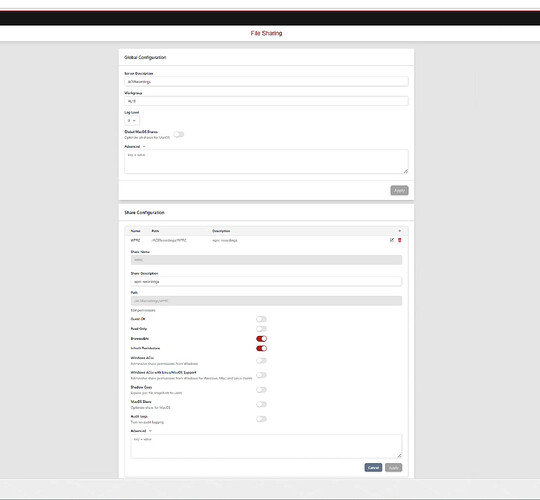

Could you also share with us your SMB share configuration on the file-sharing tab?
Hey @Hutch-45Drives, It has always prompted me for login on the windows side. It was connected at one point in time.

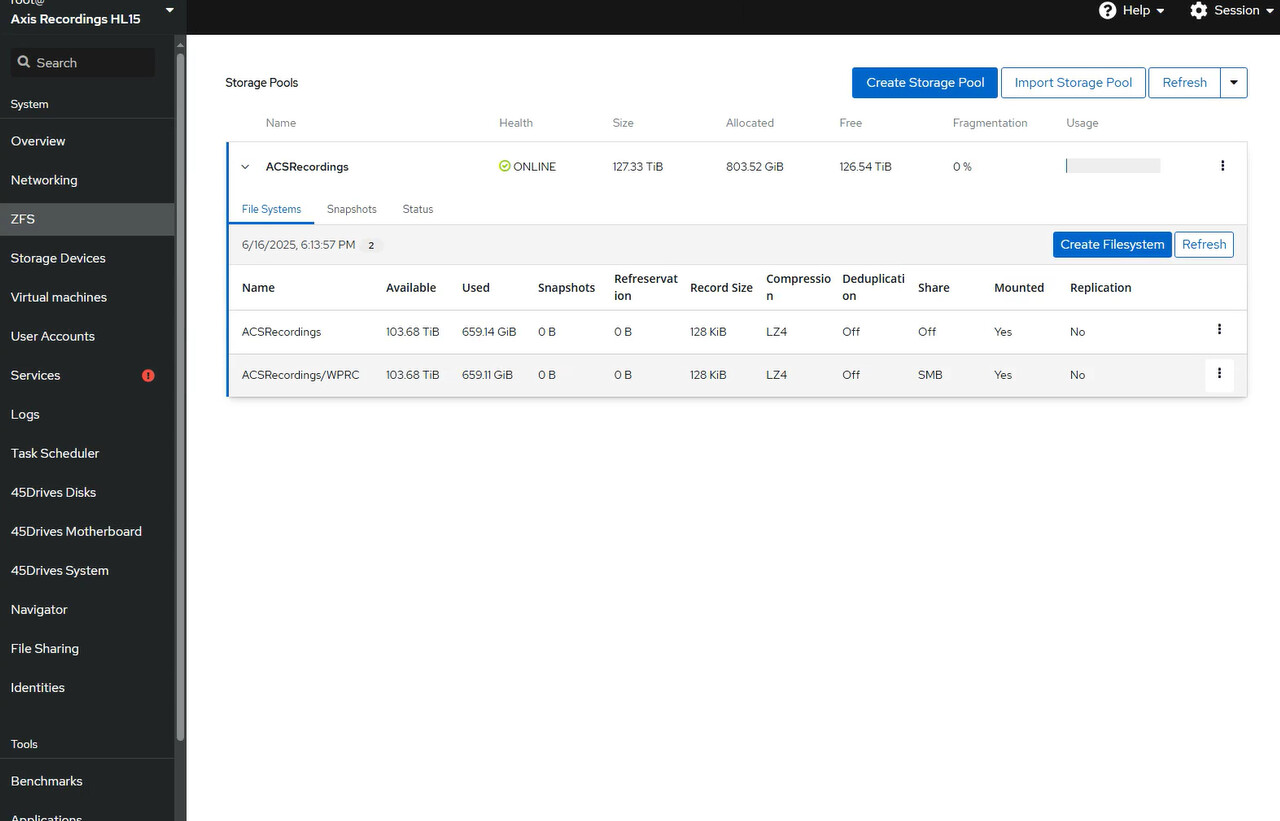

I re-created the ZFS pool/share.
Firewall is not enabled on the 45HL or the device I am trying to connect it to. (same device i am logging into the HL15 over chrome).

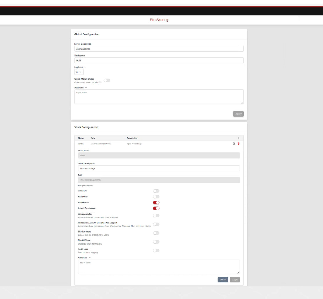

I have attached the SMB config. of the new pool. The older one is above I believe.

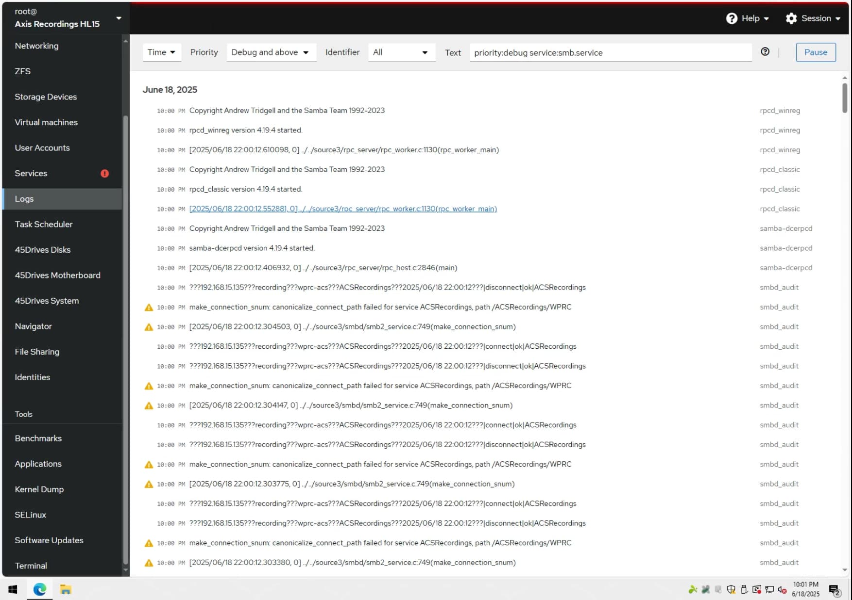

Note that SMB service restarts after login attempt? is that normal?

Do you mind showing what happens when you try to go to the specific IP
Can we also see your ZFS tab where you made the dataset for WPRC.

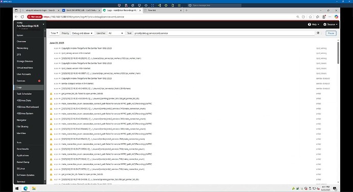

Hey @AlexD
I did a little testing on my side. Can you make sure that SELinux is set to permissive mode. You can do this by going to the SELinux tab under tools and clicking the button that says enforcing and change that to permissive. Hopefully this should resolve the issue!
Hey @Braeden-45Drives,
That did the trick.
